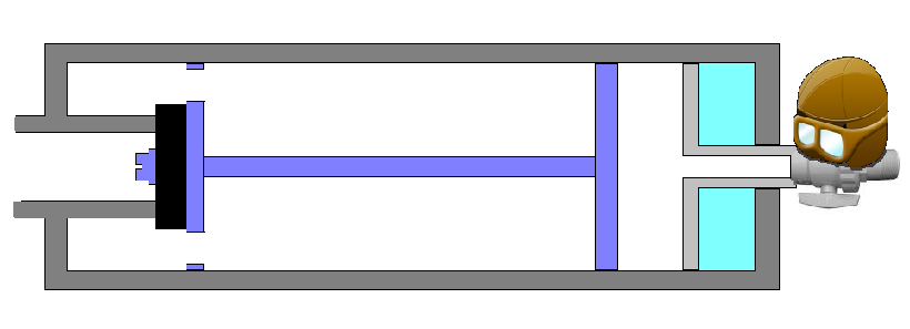

ramses wrote:And I still need advice on a bumper for a 4" toolie valve. I was thinking multiple tennis ball halves.
As I suggested before, air bumper ;) the only disadvantage in this case is a moving pilot valves but there are other possbile configurations.

The momentum is what concerns me. The air bumper is not feasible, since I am under a big time crunch. Not only do I have to finsh the cannon, but I have to make the robot that will hold it, and attach a sight and webcam, and write (easy) code to control it. We're using the TETRIX platform with RobotC.
I think I'll just fill the pilot area up with rolled up rubber scraps, tennis ball halves, etc.

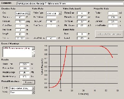

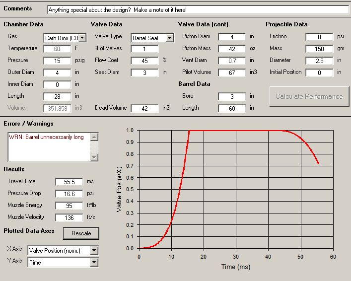

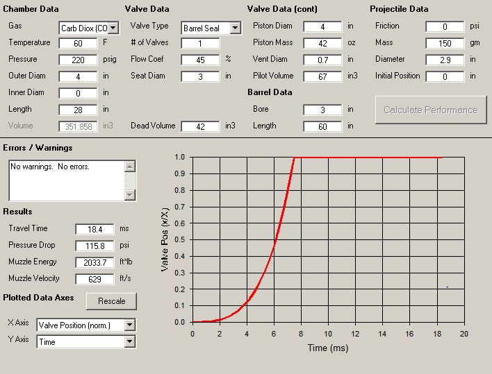

The kinetic energy of the piston when fired at 15psi should be manageable, no problem (I estimate 22J). A fairly stiff spring could even be used as a bumper, but at 220psi(320J :?)... :roll: bits of rubber are as good as anything.

ramses wrote:Was your estimate based on d/4 and uniform acceleration thorugh that time frame?
Sorry I didn't see this until now. No, actually it wasn't. I grabbed enough points from the GGDT graph to do a quartic regression on my graphing calculator, then assumed the piston would only retract far enough to open to full flow before it stopped gaining energy, and used my calculator to take the derivative of the graph when the piston would be retracted fully.
ramses
Posts: 1679
Yay! Someone else who knows how to use a calculator! Although I'm pretty sure GGDT just plots something like 10 points on the graph, and connects them with some kind of spline that fits them.
