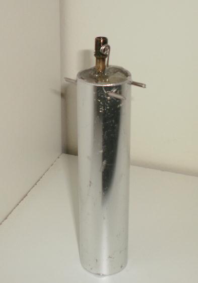

ITWOST, I started making a hybrid, just to see if i can get the mix right. If I do I'd like to start on a 3/4 or 1'' tee piston hybrid.
bit of a crappy epoxy job, didn't have enough to get a nice glassy finish on the end lol but theirs nearly 20mm of it there.
tomorrow ill get a union from work and more epoxy.
