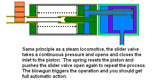

Here's another thought on the full auto from your original design, Jack. The pressure is going to make a difference in the speed of the mechanism, especially against the spring. You were trying the original design and said you couldn't achieve full auto with it. I drew this up based on your original gif with a slider valve, like the old steam locomotives had. The idea is that the pressure will be cut off automatically to allow the spring to reset the system and fire again, without the operator having to pulse the blowgun. I saw your drawing of the inline with the little ball check (looks suspiciously like a CO2 motor for a model airplane), which is far more efficient when it comes to moving parts, but I present this here for whoever wants to pick it up and run with it, or tear it apart.
You do have to have the movements measured a bit, and the pic is in the totally reset position with the blowgun valve shut.

Interesting thoughts, the solution I eventually found was to combine the bolt with a pop-off valve to "pulse" the air supply, as experimented with here and perfected here.
I also had the idea of making the bolt itself the pop-off valve but never made a successful prototype.

Yeah, thats the one I said was suspiciously like a CO2 engine. Its definitely much simpler and from the looks of it can be made inside a single sized piece of pipe or tubing. I can see modifying the right side with a hollow tube on a large 'washer' with check/flapper valves and the same in the rightmost wall would give you an automatic chamber clearing/charging capability for a combustion design as well. The spring would allow for a more than 1x mix if you set it up right.
With the experience I gained from pop-off valves after coming up with this design, probably I would make it differently with a much wider piston and shorter bolt stroke, and with some tweaking of the chamber feed the check valve and rod setup probably could be avoided.
