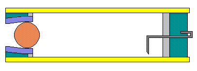

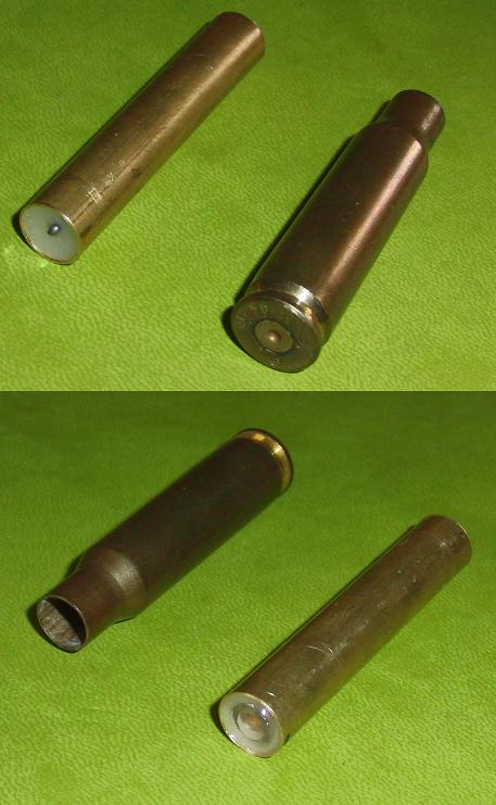

I've decided to go with a single seal, but curing with a BB already stuck in it. The problem with the first cartridge was that the outer diameter of the seal was identical to the inner diameter of the body, so there wasn't any room for expansion. Should be good for a 7-8x mix, we'll see.
edit: added some pics compared to a 7.62 NATO cartridge, note that I used Araldite, and also you can see the BB in the mouth of the cartridge.

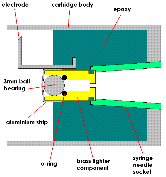

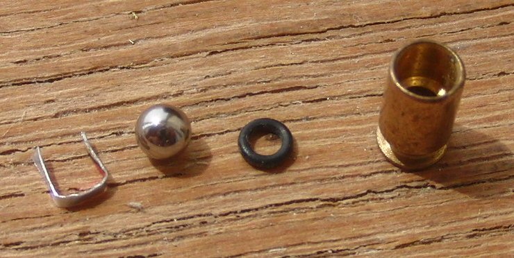

edit: while it would be a plus, I've come to the conclusion that trying to use the projectile seal for filling is not practical. Using some simple parts I managed to make a small check valve that works very well, using some parts from a cigarette lighter valve. Making my n<sup>th</sup> prototype as we speak :)

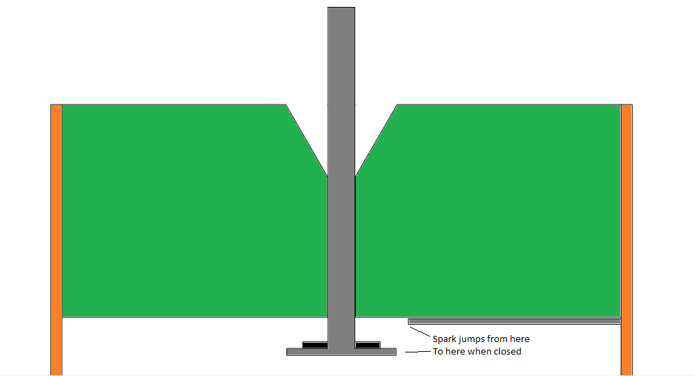

That will work but ruins the simplicity somehow.
I made a diagram of what I have been thinking about.
The valve is made from a small rod that has a washer on the end (Perhaps you can epoxy it to the rod?) and a small rubber seal of some sort. The chamber electrode can probably be made from a piano wire section or something like that.
The seal can probably be made simpler by slipping a tight fitting rubber tube over the rod on the inside of the chamber, shouldn't need the washer.
I won't work more on it before I have your response to it :P It's kind of lacking detail right now.
Hybrid cart.png (16.35 KiB) Viewed 2955 times

Unfortunately, you do lose simplicity, but it's still simple enough to make 15-20 of them which is all I will need really.
As to your idea, quite close to the original concept ;)

Yes but I think it is the best solution if you can get it to work. Since it was the original idea before you decided to try a projectile checkvalve that didn't work it deserves a try or five :)
The valve you are thinking about using now can probably be made easier and cheaper by using .22 cartriges with a hole drilled through the back. Just dent it at the "front" to stop the ball bearing from popping into the chamber during fueling.
You won't be asked why you buy so many lighters atleast :P
