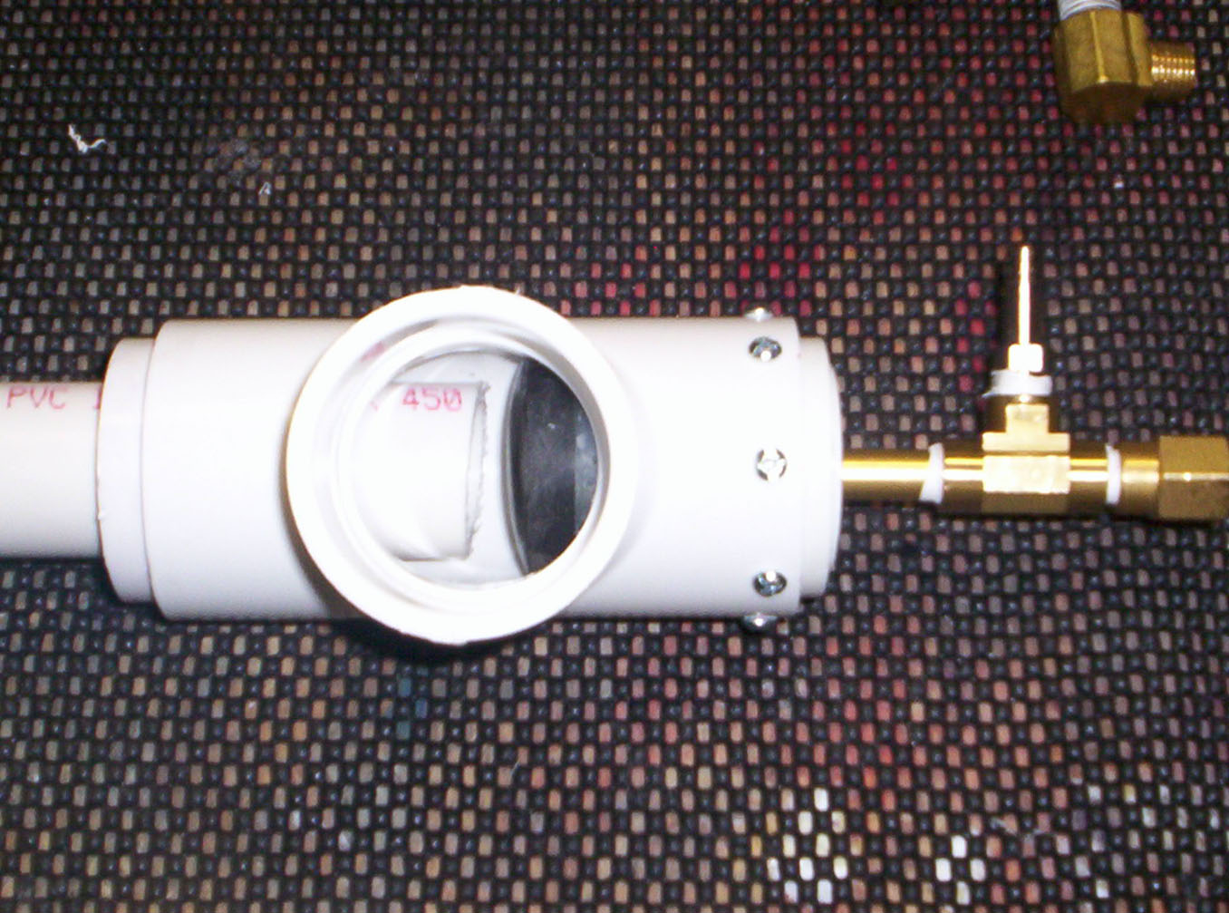

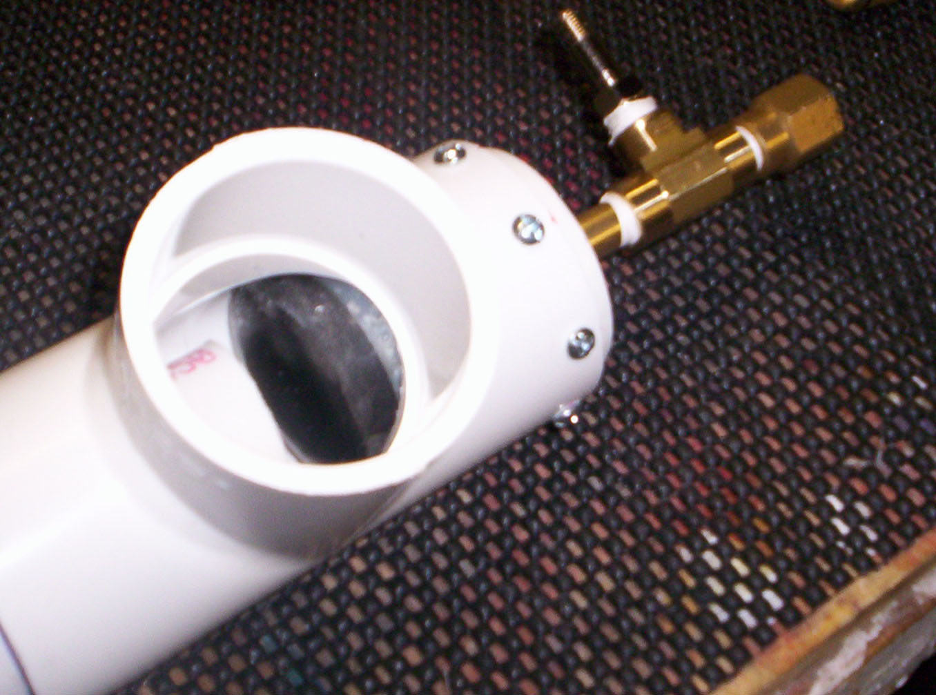

**UPDATE**
I constructed a new valve after understanding now, pictures are below. That 1" barrel you see there is just a scrap peice and will not be used. Only thing I'm worried about is the pilot travel, its only about a half inch. Will that be enough?

Joined: Mon Jun 18, 2007 11:12 am
1/2" is fine - you suppose to have 1/4 of the barrel's diameter but on a small valve like that 1/2" isn't a problem.
If you have too long a travel then the piston can just build up speed but 1/4" won't make that much difference and shouldn't cause you any problems.

Note that rule is used in co-axials only really, Clide thinks barrel sealers could do with a bit more room.

It can be calculated, you have a final figure - the surface area of your barrel which is (0.5*caliber)<sup>2</sup>*pi - to which the area available for the air to flow through the vertical "T" component must be at least identical to.
Much better now, glad you grasped the concept, and yes, half an inch of travel should suffice.

Looks very nice, clean and well made. Cant wait to see it in a gun :D

Thanks for the comments. This valve will be used on my next launcher in production, I plan to use concrete slugs for ammo molded out of 1" pipe. :)
Question: The end plug on the valve is only held in place by some screws so I can have access to the piston for maintenance if needed.. without epoxy I won't get an airtight seal will I? It seems air will leak out of the fitting if I it's only held in place by those screws. A little confused about that :/

If you cut off part of the back plug (which it looks like you did) you can take the part you cut off, and glue it into the T. Take an appropriate sized gasket and sandwich it between your back plug and the piece you glued in. You might have to shove the plug on pretty hard when putting in the screws, but it should provide a better seal, and act as a bumper. I can post a picture if you want me to.
EDIT: I've heard silicone sealant works well too, but I don't know much about it except for it's easy to take on and off.

For my gun i had the same problem, so i put some tape around where the cap fits on, then i put a little lube on it, mine creates an airtight seal now
