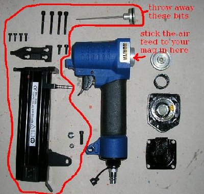

Why not get your hands on a three way valve - valve is at rest, CO2 tank feeds into piston valve pilot chamber. valve is activated, co2 pupply to pilot chamber closed off, pilot chamber vents to atmosphere and fires - and so on.
You can find such a unit ready-made and at low cost - have a look at small pneumatic nailers

would nailers be powerful enough and have a large enough flow for paintball?? i doubt it, maybe airsoft but not paintballs.Hailfire753 wrote:Thanks! Hmmm... now how would I go about modding that?

Thats what I was wondering. I was trying to think just how I would use the valve. Perhaps I will just buy a three way big enough.

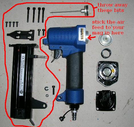

Even my small shitty nailer has a "barrel" - the section where the hammer fits - diameter of 30mm, more than enough for paintball - in fact, a bit overkill.would nailers be powerful enough and have a large enough flow for paintball??
relatively easy - remove the magazine and safety, then you'd have to open it and remove the hammer, and replace it with a feed tube that will go into your breech reloading system, same as I did here - I've attached a basic diagram.now how would I go about modding that?

Sweet, maybe that is the way to go. Barrel at the front, helical mag attached to pilot!
