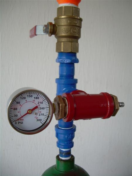

You need to think much bigger. I used size "e" medical oxygen tank which is about 4" diameter and about 26" long. Mine is very, very simple and VERY cheap. Tank cost was only 10 bucks (ebay is your fiend). This thing is a beast that weights in at about 20 pounds all up which actually works well when launching large/heavy projectiles.
It took me all of 15 minutes to screw everything together using teflon tape on the threads. To eliminate leaks the fittings are very, very tight. As it has already been said all I had to do was put the tank in a vice and unscrew the unwanted regular. It was in very, very tight. Let me repeat . . .it was in super tight.
Should be NPT threads on that c02 tank. My oxygen tank is 1/2" NPT. I wish it was larger, but it still makes for a sweet tank. Here is a picture showing how I put it together. No wise cracks on my paint colors.
In have multiple barrels ranging from 1" to 3" diameter. I have a 1.5" barrel that is 10 ft long. Launches whatever I want very, very far despite the inefficient ball valve.
- DSCN1998 (Medium).JPG (24.73 KiB) Viewed 5503 times
I did the same thing with scba tanks that firefighters use...I wasnt satisfied with the small tank outlet threads so I had them drilled and tapped to 1"NPT....They are even larger than your oxygen tank but lighter since they are fibre wrapped aluminum......They work very nicely but I would definitely go with a faster valve when you get the chance....Even a modded sprinkler valve @ 150psi will out perform that ball valve @ higher pressure....Nice set up .

Thanks. I'm not to excited about my small outlet either. I'm not convinced that a faster valve would make much difference because I think the air flow constraint in the system is size of the outlet and not the ball valve.EGOed wrote:I did the same thing with scba tanks that firefighters use...I wasnt satisfied with the small tank outlet threads so I had them drilled and tapped to 1"NPT....They are even larger than your oxygen tank but lighter since they are fibre wrapped aluminum......They work very nicely but I would definitely go with a faster valve when you get the chance....Even a modded sprinkler valve @ 150psi will out perform that ball valve @ higher pressure....Nice set up .
I wanted to drill and tap larger threads but I don't have heavy enough equipment or a large enough tap. My buddy has the same basic set up but he cut off the bottle where it necks down and welded a 1.5" coupling. He has a HUGE opening.
Yes , I was thinking about cutting the neck also since I still have another 12 tanks to play around with....I could easily go 2" NPT if I did that and coupled to a metal piston valve would give me extreme power and range at high pressure.....Right now I am limited to 150psi max with the 1" sprinkler valve setups and hose that I am using....I hate to let those tanks go to waste , but the small outlet porting really limits you as far as making large bore cannons...I am going to have to go with 2" steel pipe for chambers until I can get those tanks modified I guess.
