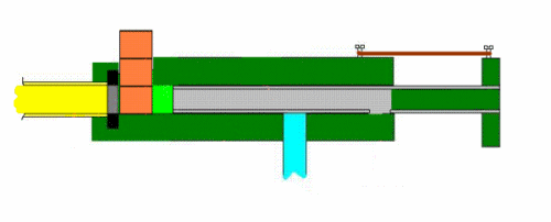

Technically, when you let the air in it should push the projectile out of the barrel and also push the bolt back. I doubt it there will be enough energy to push the bolt back enough to cycle the action, which is why my plan includes some sort of electric drive that will do the job. However, pending on friction and spring strength, it might not be necessary.
edit: this is what the mechanism should look like in action, for simplicity's sake the spring has been replaced by a rubber band for the animation.
- blowbackani.gif (29.37 KiB) Viewed 4028 times
...there is something that kinda gets my attention...when you actually get it to shoot, the air instantly pushes the piston back. so, the projectile stops accelerating while still in the barrel. What i'd recommend is you use a small captor, that opens the solenoid when the projectile passes next to it, thus allowing more air to be used to propel du projectile.
I'll go with one spring first, if the friction is significant I'll add another one.Hawkeye wrote:I still say balance the spring tension. Put a band on either side if you don't want to back it up with a spring.
The projectile and the bolt both have the same force of air acting on them, however you have to consider that the projectile is small and light, while the bolt is heavier and also is being held by the spring - this means the bolt will accelerate slower and hopefully give the projectile enough time to leave the barrel before closing off the air. This is similar in concept to how blowback pistols and submachineguns work.when you actually get it to shoot, the air instantly pushes the piston back. so, the projectile stops accelerating while still in the barrel.
The advantage of this design over the blow forward experiment is that the spring is out in the open so I can easily play with different tensions to fire tun the mechanism.

You mean using a compression spring like my cartridge fed pneumatic? It would work, but I'm going to give tension springs a go first, more compact

if you want more force on the bolt for blow back just give it more suface area or increase the size of the bolt
i'm building it as per the diagram for now, I'll try and "tune" it by playing with the spring strength and preload.
Just a thought, would you need to put some sort of bumper between the outside part of the bolt where the spring is where the T part of the bolt contacts the gun. If the force was large enough, maybe you would but you this bumper could possibly help the cycle action to continue on its own. If it was some sort of rubber that would give a nice ricotcheing force, then this cycle action maybe possible without a solenoid valve thingy.

Naturally, some form of bumper to stop the bolt from flying out completely would be in order, pending how much force is actually going to be on it.
