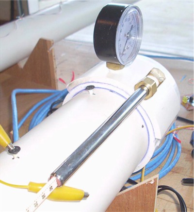

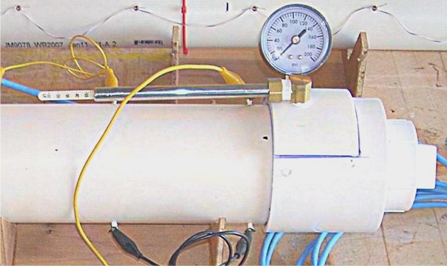

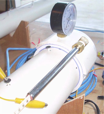

Here is how I fitted a tire pressure gauge to a chamber. The brass fitting is an elbow with 3/8" copper swage (compression) fitting on one end and a 1/4" NPT male thread on the other. I had to hone out the ferrule and nut of the compression fitting a bit with a dremel to get it to slide over the gauge body.
The dial pressure gauge is also a 1/4" NPT male fitting.
