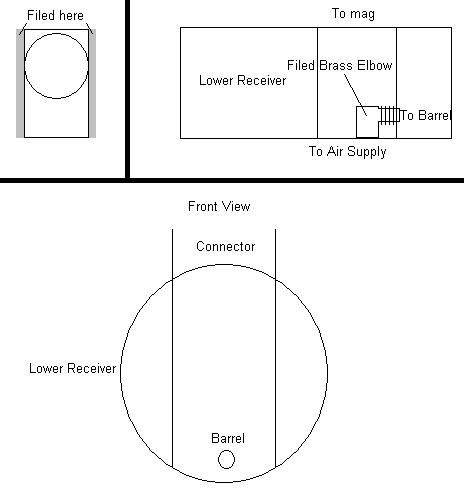

Here is what I have considered. This is actually a combination of the vortex cap and elbow cloud. The setup is similar to that of the D - Mag from Davidvaini. The mag bends into the lower reciever and is connected with a 1" piece of Sch40 pvc. At the bottom of the piece, however, is a brass elbow (1/4" npt, male to female thread). It is filed on the sides to allow the BBs to enter. It is screwed down to the lower receiver, inside the connector piece, via the female end. The male end will support the barrel.
It is a little different from BTB's elbow cloud design. This is more of a brass vortex inside a cap. The biggest reason I didn't want to use the vortex cap idea by itself is because it would have off-centered my barrel. The brass will also stand the higher pressures.
Now, I understand that I will probably not be able to push 800 - 850 psi through this. But I will be able to push more than 40psi. Regged, I'm thinking 250psi.
Any suggestions with my design?
- The lower receiver and mag are completed. I have yet to piece in the brass elbow, as I would like input from you guys beforehand.
- untitled.jpg (20.65 KiB) Viewed 2692 times

I don't get what you are talking about at all...
Is that just an elbow with the sides cut off hoping that the BBs will be pulled in by the tinsy venturi effect? It seems that unless you have a gigantic elbow, there wont be enough room for the BBs to slip in easily.
The mag is above the lower receiver. It is set up so that the BBs are pushed forward, then drop down around the elbow and in to the 1" piece of pipe. From there, the air pushes the BBs out the elbow like a normal vortex block.
Basically, this is nothing more than a easy to make vortex block.

yeah thats the problem with the D-Mag is that the barrel isnt centered unless you move the cap over... But my vortex cap idea sure is good for size and for less pressure loss.
But you know that you could go with a brass or steel pipe and cap for your design and it would easily handle the pressures and would be a perfect circle for your vortex... but I do agree that the barrel would be off to the side unless the cap is moved over...
