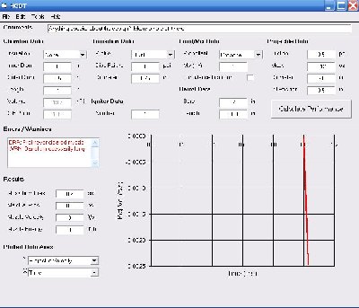

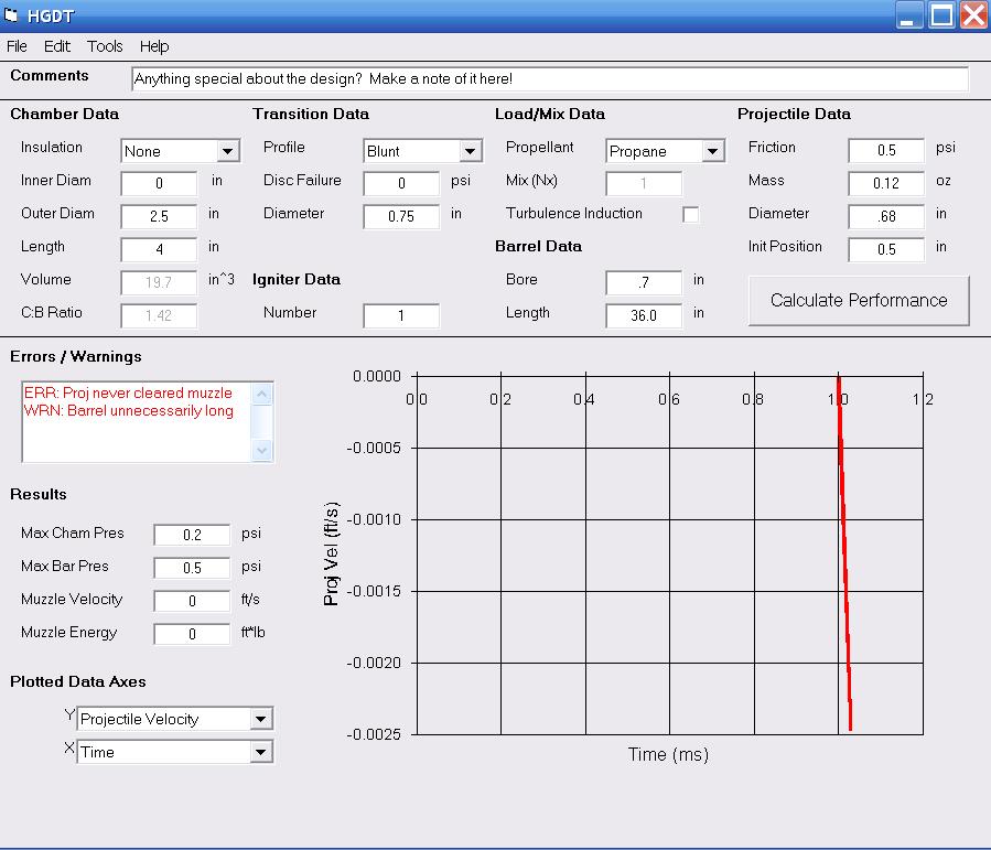

Setting the burst disc to 0 with a reasonable gun gives me
ERR: Proj never cleared muzzle
WRN: Barrel unnecessarily long
