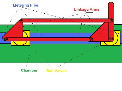

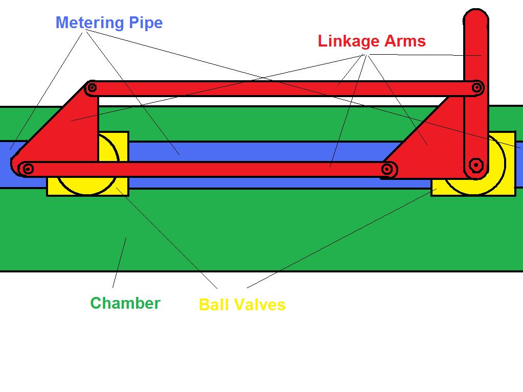

Now the question is how to make a 5 step loading process quick, easy and reliable. My idea is to try to put link arms between the valves connecting them to make one single action. When the chamber side valves close, they come in contact with the ignitor shooting it. A mechanical solution, but it's what I'm best at.

Well I don't honestly know all that much about DDT. All I know is that it is extremely powerful, only occurs at absolute optimium fuel mixtures, and is nearly unpredictable. It sounds like a force not to be messed with. Anywho, I found that the quick diagram I drew up won't actually work because the linkage arms will conflict with eachother. Can anyone think of a solution for this?
