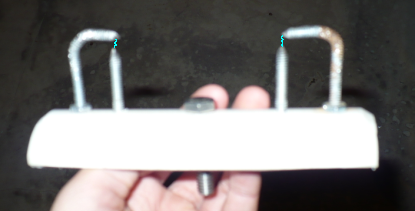

Here's my latest spark gap effort.
A little overly complicated parts-wise but very reliable, gets the spark up in the center of the chamber. I'm trying some other ideas at the moment to get the parts count down.

Starman
That "chamber short" is very nice. The wing-nuts are pretty clever. Do you put a dab of lock-tight on'm to keep'm from moving?
I would say that your setup isn't a "spark strip". Seems to me people usually mean something along the lines of copper clad board when the talk about a spark strip. One of Latke's strips:
