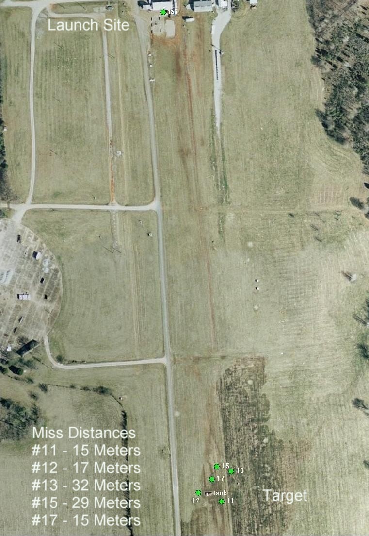

I was allowed to go onto an army Arsenal and fire at a tank. The tank was 500M away and the results are in the photo. Sadly it was a windy day, so I had poor results.

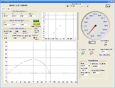

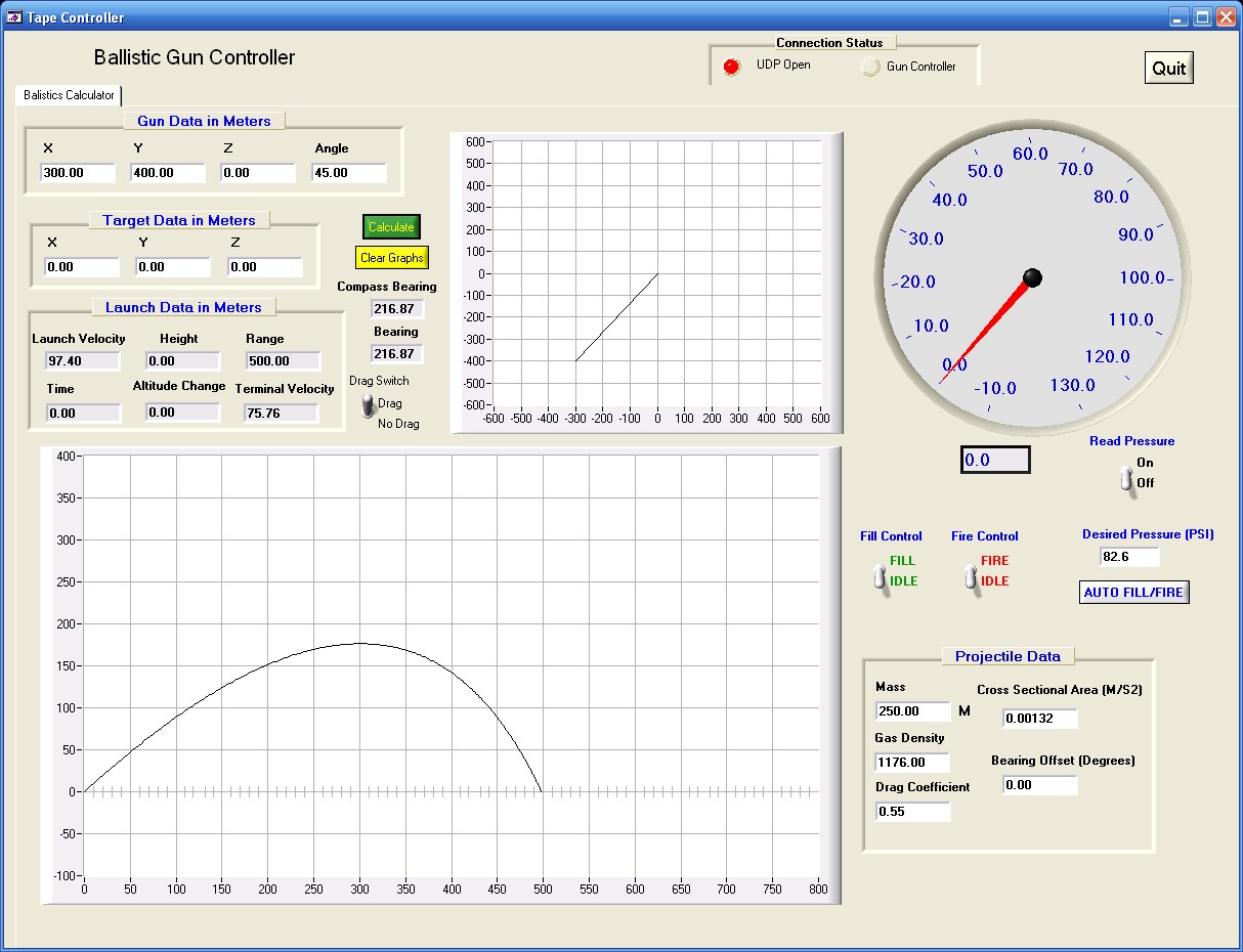

This is a Screen Shot of the UI of the program I created.

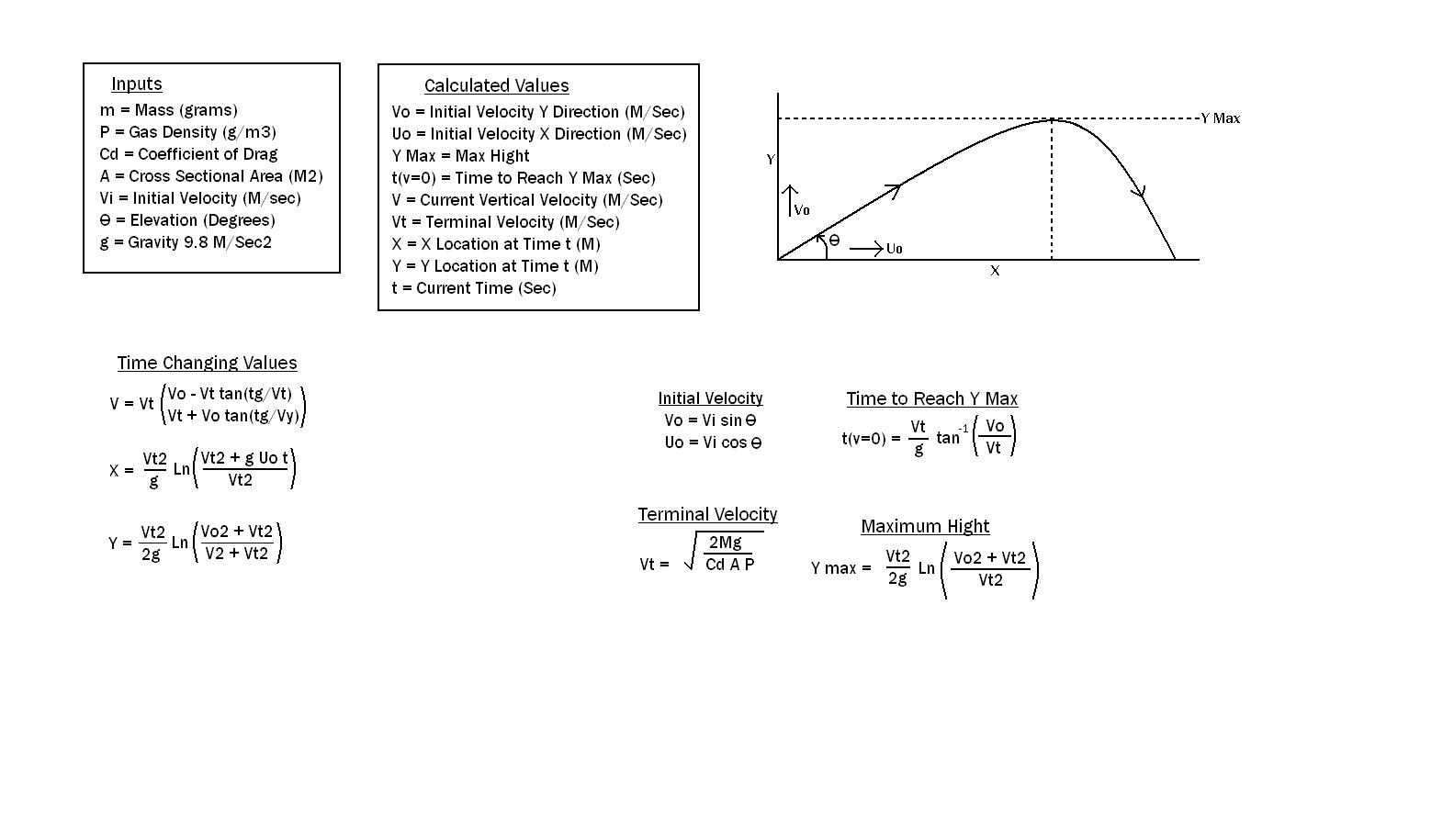

A Diagram of the various Calculations used.

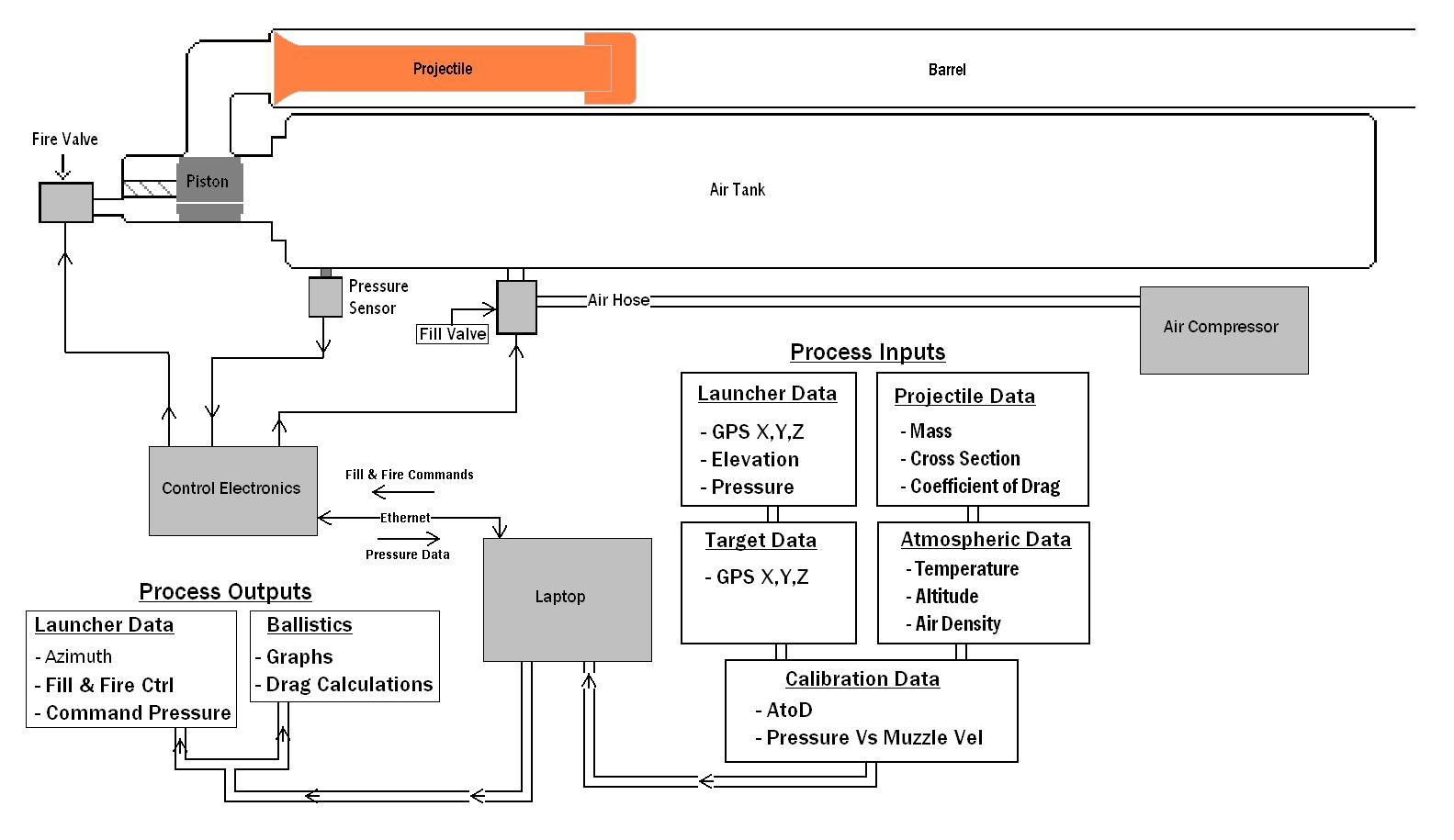

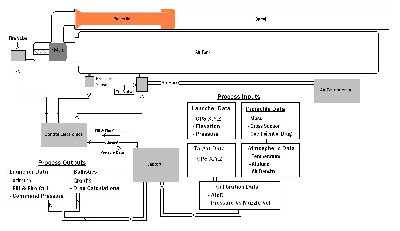

This is a Block Diagram of how the various componants interact in the Launcher.

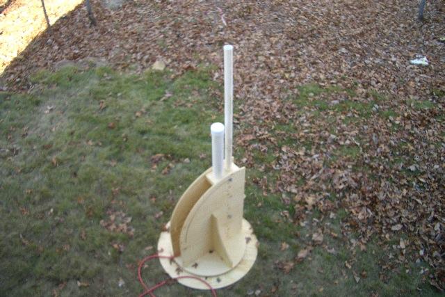

The Launcher
The Launcher

very nice work. Not as bad ass looking as I was picturing but still a very nice cannon/program you have made.
I would recommend a jet-black paint job with a few warning decals on it. Hell, maybe even a few different colored led lights around the muzzle for some high-tech pizazz lol.
Again, nice work :wink:

Haha yea its not actually all that intimidating looking, But it fires very well and consistently. (Which is what I needed for the project)
TwitchTheAussie
Posts: 980
Kinda reminds of a a mortar. Not as good looking as I thought it would be but hey its got balls and thats what counts for me :thumbright:

I'm just curious, what did you use to make your UI program? I'm thinking of making something similar.

'Lab Windows CVI' was the software I used.
It is super easy to use if you are competent with C, and it has some great example programs if you ever get stuck.
After I finished the project I actually got a call from a guy that worked for National Instruments. He heard that I had used their product for my project, and he wants me to give a talk at one of there quarterly meetings to demonstrate how I had implemented there program.

I severely doubt that launcher is capable of firing 600m.
..Got any videos?

Got specs of the launcher?
Never take life seriously. Nobody gets out alive anyway.
yeah there are no specs of the gun...
that's really amazing project... well even if it is just another PVC pneumatic with a bit of electronics
are you going to upgrade the gun itself ? like make it all steel and fire it at 400 psi ? :twisted:
M.J.P.
Posts: 48
Joined: Thu May 08, 2008 2:36 am
Or if you dont wanna give specs atleast a pic with another object in it so we can get an idea the size?

I am interested in the actual pressure sensing and firing devices you used. Also, did you use sound card IO on the computer or something else?
Nice build you have there!
Edit: Opps sorry read it again....you mentioned the Rabbit controller.
