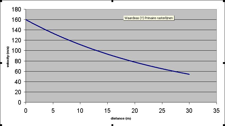

I found that the drag coefficient of my bb (0.12g, 6mm) balls was 0.25. The function that I got was y=0.1036x^2-5.773x+b where y is your velocity at while it has flow distance x, b is the muzzle velocity. Get 5 data points and fit these to this curve inorder to get b. This only applies for 0.12g 6mm plastic bbs (with no seam). Btw the units are metric(meters and m/s). If I have time I will make a more general formula, that would be pretty cool:)
The picture below shows a curve with a muzzle velocity of 160m/s:
