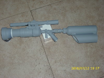

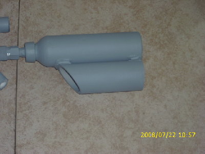

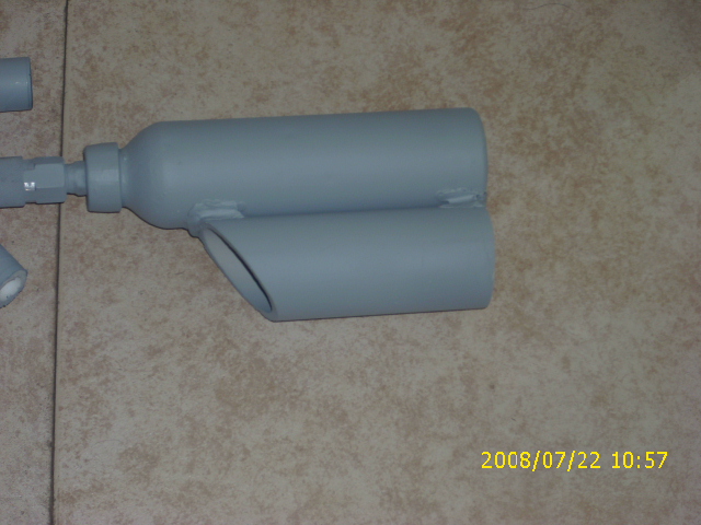

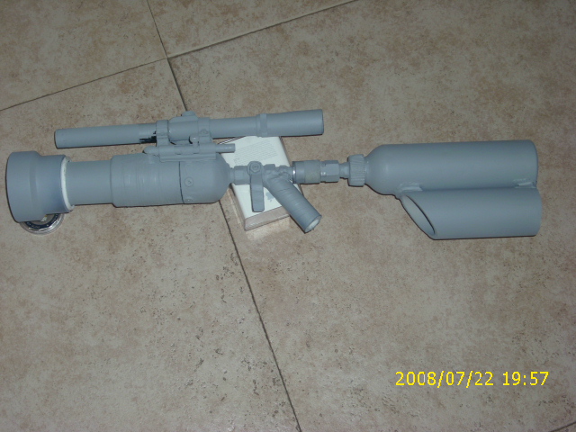

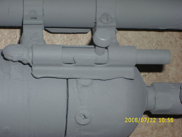

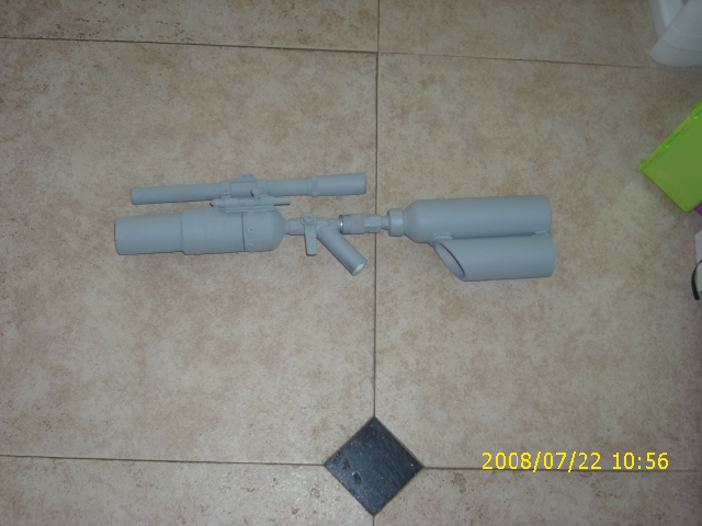

Updated Pics.

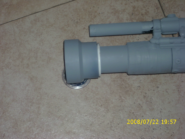

Either today or tommorrow I will get a 1 1/4 inch to 2 inch bell reducer to put on the end of the gun as a muzzle brake.

Although I can't see the scope being very useful because the barrel is so short, the range is probably limited. But scopes are fun anyway.

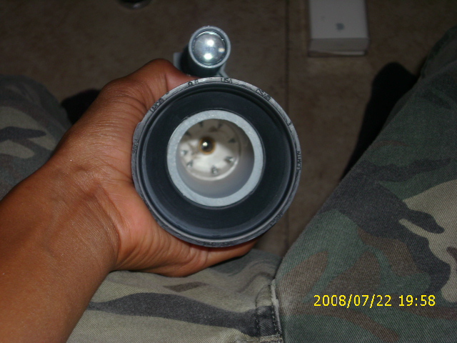

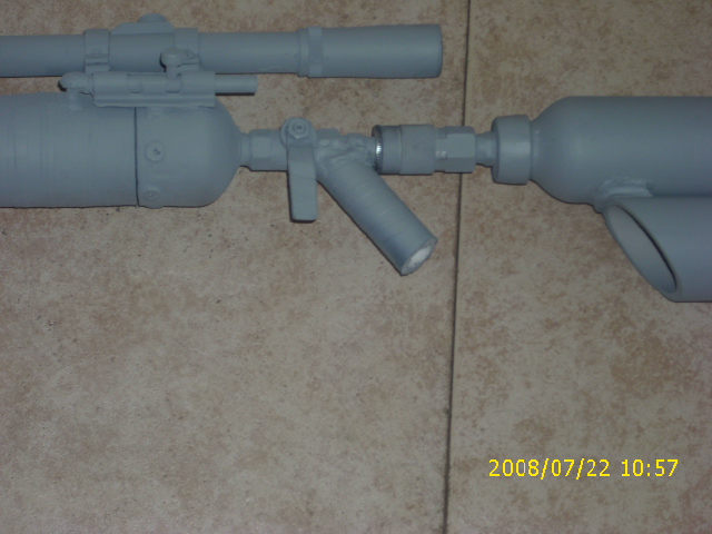

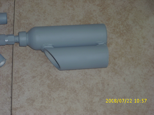

Also, Where do you fill it from? And what kind of fitting is the barrel attached to? Looks like an end cap drilled out(?) 8)

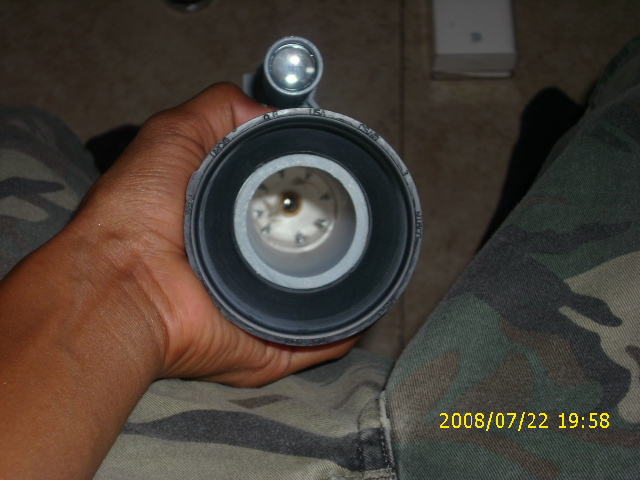

The barrel you see does nothing. The "barrel" you see is inside of a coupler. what I do is put some wadding inside the encap, then fill the endcap up with bbs, place a burst disk over the ammo, and close the bolt. To fill, I remove the stock via quick connect, and fill up the stock through a quick connect, and connect the chamber back onto the gun, via quick connect. And sinse the chamber is aluminum, I have no worries of Resting my cheek on it and it exploding. Basically what it is is a shotgun, that can shoot 200+ feet, so the scope is very good. I am going to home depot in about an hour or 2, so I am going to get a bell reducer, and drill holes in the end of it.
ANOTHER UPGRADE: I added a 1 1/4 inch-2 inch ABS-DWV bell reducer on the end. I will either drill some holes in the end or get a triangular file and make it serated(?)
