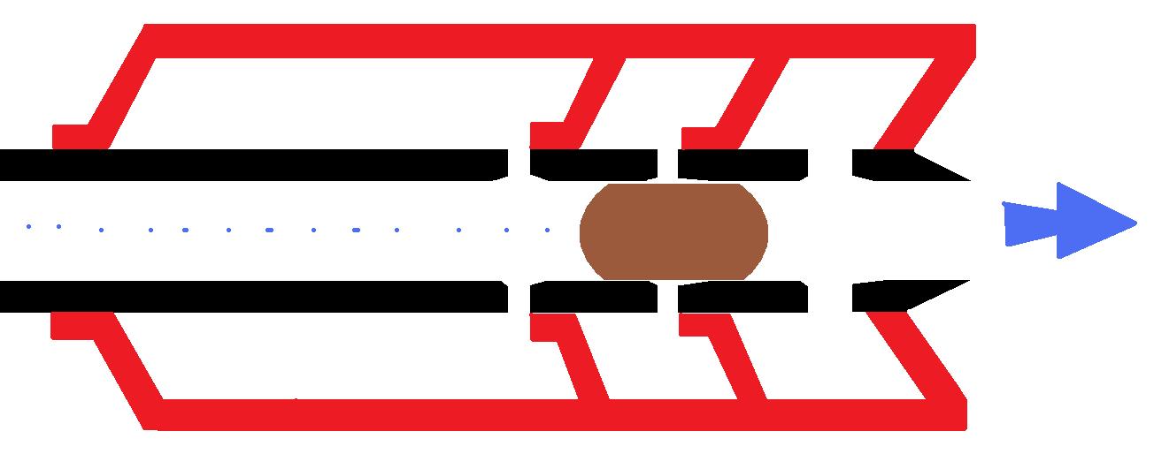

Looks like a good design. Maybe more baffles than pic.
It's really a matter of having enough baffles spaced properly and the diameter. Some professional one's have slanted angles creating chambers or cone shaped baffles with points inward (muzzle). Flat one's are ok just longer in length.
A Good idea (especially for smoothbores) is to sandwich a rubber washer (with slightly smaller diameter hole than projectile) in between two metal washers (with a bit larger hole than projectile).

As to the design that's the subject of this thread, I would advise against having baffles beyond the edge of the barrel, due to the fact that most spudders fire irregular and unstable objects out of their barrels that would start to tumble and potentially destroy the freestanding baffles. The same logic applies to shotgun suppressors:
i would also suggest adding something along the lines of a gas redirector (something that you would see on a Barrett M109, or other .50 cal bmg) this still wont 'suppress' the blast, but it will redirect the cold and warm gasses in multiple directions... remember; nothing can completely silence the sound; only make it less recognizeable. uk spudgunner is absolutely right; your cannon will still be pretty loud even after constructing a proper suppressor. no matter what you build for your spudgun; you will NEVER end up with a hollywood 'wisper' gunshot. lol
As stated earlier; it is extememly important to have the baffles lined up correctly...for my design, i suggested having the inner diameter of the baffles slightly larger than the potato cannons barrel. and the reason that i have a small amount of baffles is becasue the more you add; the more chance that you end up with mashed potatos inside your silencer... if not, you may end up with your suppressor shooting off entirely with the snagged potato. always be careful when attaching something to the muzzle of a potato cannon!
Ps. Jackssmirkingrevenge; thanks for the insight on placing the baffles overtop of the barrel!
here is a new design i am working on... the black is the original cannon barrel, the red is the PVC Suppressor and the brown thing is the potato
i plann on drilling holes in the end of my existing barrel at select intervols (corresponding to the location of the baffles in the suppressor). because the holes that i am drilling are inside the barrel; i plan on using a file to smooth out the inside edges so that the sharp edges dont cunt into the potato while it is either being loaded or is being fired out...
to create the angled baffles in a cone shape; i was thinking that 2''to 3'' converters would do very well (they are allready round and fit snugly at both ends) i plan on making the expanison chambers much larger than what is pictured. the first chamber is likely to be roughly a third the length of the barrel.
Anyone have any suggestions on how to make it better?

So, if you did build it, <strike>did</strike> does it work? How much <strike>is</strike> do you expect the sound to be reduced versus the affect on the muzzle velocity?

I wasn't asked the question but let me say, years ago I saw a homemade one, like I mentioned, mounted on a semi-auto .22LR.So, if you did build it, <strike>did</strike> does it work? How much <strike>is</strike> do you expect the sound to be reduced versus the affect on the muzzle velocity?
With sub-sonic ammo (Below about 1140 fps) the only sound heard was the firing pin click and then the bolt and spring click-click.
Also a moment later a whomp (soil) or whack (harder stuff) the projectile impact.
With supersonic (several normal .22LR bullets) same thing only a moment after firing a cracking KaKrrrrr...of the bullet's sonic boom. Still much quieter (but distinguishable sound).
For it's size the .22 has alot of pressure. similar to a miniature .44 mag.
So I would infer any thing could be silenced equally (with a scaled up suppressor).
As for Lost velocity Probably significant to none. Since the suppressor is mounted on the end of the muzzle and there isn't any applied increase after leaving the muzzle.
If holes are drilled in the barrel then there will be loss similar to a shorter barrel. But it's not necessary to drill holes. 8)

"So, if you did build it, did does it work? How much is do you expect the sound to be reduced versus the affect on the muzzle velocity? " -jimmy101
i built a cannon with a silencer that had the baffles in front of the barrel...it does work, but not as well as i would like. in the first post with two pictures the first one should work better (thats the one i am trying to build right now) it should work better becasue the baffles can make a more air-tight enclosure around the potato, however there will be slightly less speed to the spud becasue there is a continuation of the barrel but the pressure behind the potato is being let out (becasue of the holes drilled at the end)... but im hoping the drop is not too significant
That is my worry, loss of power and speed. I'm now using tennis balls and they are designed to slow down by themselves. Well, I guess if I don't build one I won't be able to use my launcher very much. I'll try this weekend and let you all know.
Anything will slow down by itself.ralphd wrote:That is my worry, loss of power and speed. I'm now using tennis balls and they are designed to slow down by themselves.
The question is whether you're trying to use the effect to your advantage, or whether you're trying to minimise the effect.
With combustions, the same logic of cooling down propelling gasses to reduce pressure and therefore sound applies, meaning use should be made of steel wool or wire mesh to fill the expansion chambers. Also remember that volume is very important, more important with spudguns than conventional firearms, so make the biggest suppressor body you're willing to live with.
