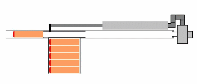

3-way valves aren't really that hard to get a hold of. McMaster has all kinds of them (pages 958-965). You could mod a blowgun to work as a 3-way; the flow isn't great but it is enough to trigger a QEV. Or use Ebay, a quick search turned up this one, I'm sure you could find cheaper alternatives by looking around. http://cgi.ebay.com/Pneumatic-Manual-Va ... 0292808158
As an estimate to check whether or not your bolt will be opening before your dart leaves the barrel, find the minimum pressure required to move the cylinder all the way forward, then take your chamber volume and barrel volume and use P1V1 = P2V2 to find the pressure in the system when the projectile is at the end of the barrel. If it is higher than the pressure needed to keep the cylinder forward then you don't really have a problem.

I suggest something like 4622K53 - It's entirely manual, and it's designed for operating QEVs and pneumatic cylinders.PVC Arsenal 17 wrote:I scoured McMaster for days... the most they have is a 3-way, normally CLOSED valve which is no good for this application.
Basically, there's a sleeve that when pushed forwards connects the supply to the system, and when pulled back vents the system to atmosphere, which I think will do what you need it to. (If not, enlighten me as to what it is you DO need)
I used the same thing (well, one I bought in the UK) to pilot the QEV on HEAL.

That is what he is using in the videoRagnarok wrote: I suggest something like 4622K53...
But you do bring up a good point, what is wrong with using the slide valve? You can put a spring on it so you don't have to move it in both directions. The stroke may be a little long compared to a push button valve, but since you already have one it is quick and cheap.

I'm starting to realize that my intended configuration is not so great. I already started playing a few different ones so I may consider using a slide check. It just wasn't practical in my original configuration. The one I have is leaking like hell though...

I'm glad to see someone else is using this design, your nerf gun should be awesome.
I've made a bb version, using a homemade ram and piston valve. I had the same trouble as you for the pilot 3-way valve, I ended up using an extremely ghetto 3-way valve made of two blowguns facing in different directions. One is the exhaust and the other was fill, and they are rigged so one is closed while the other is open. It works, just it isn't optimal. And with mine I have no trouble (as far as I can tell) with the bolt retracting from the shell prior to firing, possibly because of the overkill chamber/barrel ratio.
Good luck with this, I look forward to seeing it completed!

Hey thanks for the animation, JSR! What program did you use for that? I could use a simple program for some of my projects.

I use Imageready because I have nothing else. But that statement isn't completely accurate. I use a version of Imageready that went obsolete 7 years ago.

Jasc animation shop, it's part of the paintshop pro package but I think you can *wink wink nudge nudge* download it separatelyPVC Arsenal 17 wrote:What program did you use for that? I could use a simple program for some of my projects.

so far it looks promising... acctually it's so simple that it's almost 100% sure to work good....
spend more time searching for 3 way valves... I am sure that there are hundreds of places where you can buy them..

I've settled on a simple slide check. I'll stick a spring behing it and make some sort of trigger. Can't get anymore simple than that!
