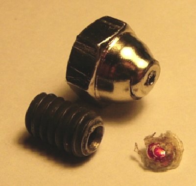

Well this concept has been floating around upstairs for the past few days so I decided to put something together.
It's a 1/4" acorn nut with a 3/64" (smallest drill bit I had) hole drilled in the end, and a 1/4" set screw with an 1/8" hole drilled through. Couldn't find paper caps so I dug out the contents of a plastic one, and sandwiched it between tape and aluminum can. This allows it to seal the chamber but still be struck from outside.
The nut is cracked because I turned the screw in too far, not from the cap.
I used a drill bit turned backwards for a firing pin. It wouldn't work just holding it in my hand, but when I set it on the table and gave it a light tap it fired.
I'm not sure if it's something I'll pursue in my next cartridge cannon, but thought I'd throw it up as a reference.
Anyone know the temperature this might burn (detonate?) at? All I could find was that it's similar to 'armstrong's mixture', but couldn't find any data on that.
I'll try building a rig to photograph it with low light/long exposure and see what kind of flame jet is coming out of the hole.

It is pretty much arm strongs mixture. I can tell you it will ignite your gasses if done correctly. 10grams will DESTROY a piece of paper, but be careful, 10grams will also DESTROY your hands from the wrist down wards... :twisted: The idea os ok but how will you fire fom out side the chamber and how will you prevent the alli from going right through you, i would try a little harder, explosives are serious things and not something you can just play around with toi see if it works, chances are you wont be there to make it work after you first failure, even a cap gun could become dangerous...!

And that's why I'm using a single cap. Which if the package is accurate is .01 grams. Seeing as how they are still sold today to be fired in plastic toys by children, I'll take may chances playing around with it encased in steel :roll:.

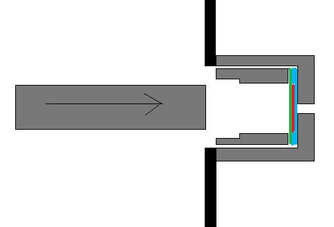

It is fired from outside the chamber via a simple spring loaded firing pin. How this and the cap holder are integrated would obviously vary depending on your cannon design. The tape/aluminum sandwich seal the chamber so that it works for a hybrid (like a mini burst disk, minus the bursting). The combination of a small hole and firing pin backing would hopefully keep the aluminum intact, but if it fails you could move to a steel disk instead.
Edit: file comment. Also, do you think gluing it into the neck of a pop bottle for trials would cut down on the sound level, or is there going to be too much coming out the back to matter? Caps are louder than I remember them being, and I need to be able to test this inside :?.
Green=aluminum, red=cap, blue=tape.
