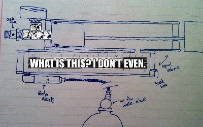

Just thought I'd run a quick pump design by y'all...
How's it look?

Lockednloaded wrote:How's it look?
Sideways :)
1) boooo dead volume
2) if the venturi is already ensuring an adequate fuel:air mixture, what's the purpose of the secondary chamber?

I presume so the mix isn't changed by the pump sucking more air than needed through the venturi.

The dead space is the volume of one 1/8" tee, and I need it to have the gauge to measure the mix.
And Zeus, that's exactly what it's for
