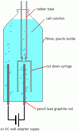

Bit of an update on this, I made a crude electrolysis setup in a bid to give an oxygen/butane atmospheric pressure "hybrid" a go, tried it out yesterday with sodium chloride but naturally I got a nice smell of chlorine gas from the positive terminal. I'm going to give it another go later with sodium hydroxide, yay for working in a lab
- o2generator.gif (6.3 KiB) Viewed 3825 times
:angel10: :angel10: :angel10: :angel10: :angel10: :angel10: :angel10: :angel7: :angel7: :angel7: :angel7: :angel7: :angel7:I got a nice smell of chlorine gas from the positive terminal.
