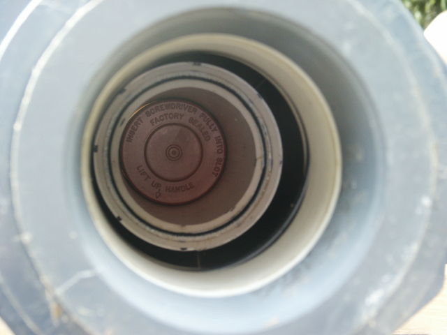

sputnick wrote:
but the damned piston will not work, probably because it's so small it's hard to get a nice piston, If it just lies flat against the piston, it doesn't seal.
In one of my home built QEV cannons, I had the same problem. Even if the barrel is perfectly flat, sometimes the T isn't perfectly straight so the piston hits the seat at an angle. My solution was a dowel with stick on sandpaper on the end that could fit the same diameter as the piston. With the dowel aligned in the valve cylinder, it is rotated to sand the valve seat perfectly true to the valve cylinder. To tell when you are finished, I paint the valve seat with sharpies. When the painting wears off evenly all the way around, you are done.
Attached is a photo of the breech of a tennis ball cannon with a 2.5 inch barrel that I built. The piston o ring is in the cylinder wall to keep piston mass down. Note the black marks on the valve seat. They are now evenly worn down from sanding the seat true.
The o ring in the valve seat is to reduce the piston mass. The groove is filled with caulk and the o ring is squished into place. A greased piston holds it in place while the caulk sets for a true seat.
Cannon spec TB cannon.
6 inch chamber coaxial 28 inches long
2.5 inch barrel 8 feet long.
3 inch piston.
Valve seat o ring diameter 2.75 inch
pilot valve 1/4 inch ball valve (this is a quick exhaust main piston)
Weight, too much!
For size comparison, that is a full size spray paint can in the barrel.
:D
Breech of 2.5 inch QEV tennis ball cannon.
