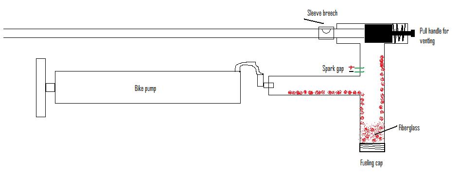

But since my complex projects don't seem to get far off the ground, I'd like to throw something simpler together for now to experiment with the fuel. Enter the picture, below.
It's really just your basic piston hybrid, likely made out of 3/4" copper. But for fueling you would unscrew the cap on the bottom and spray in the starter fluid to saturate the fiberglass. The fuel would then wick up the fiberglass into each arm of the chamber to enhance vapourization. But would the addition of fiberglass possibly be overkill, and lead to a rich mix out of flammability range?
Eventually a hybrid version of Rambo's auto combustion, perhaps?

A wick provides a huge variable to the metering of fuel. How much evaporates? How much resudial is remaining to make the next shot too rich, etc.. Is the chamber warmer after a couple shots? It would be a liquid spray and pray.daccel wrote:Well, I think I'm going to pursue ether as a fuel, given the promise it shows.
It's best to have a fresh dry chamber for each shot and a metered amount of fuel fully evaporated for consistant shots.
The multiple shots indicate the mix is too rich as you have unburned fuel left over.
Well it would be easy enough to do some trial and error with and without a wick, I suppose.

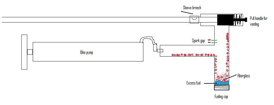

Forgot to show it in the diagram, but the idea is to have a small pool of fuel at the bottom to allow multiple shots without manually re-fueling.
Agreed, that is what you'd ideally want. But I'm willing to sacrifice some efficiency/power/accuracy for ease of construction/use, if I can make it fire reliably.
While it is likely, the multiple shots don't necessarily indicate a rich mix, because the mix could be accurate in terms of vapourized fuel, but with liquid fuel sitting in the chamber that subsequently vapourizes and mixes with the next batch of air. Optimistic, perhaps, but in theory...
