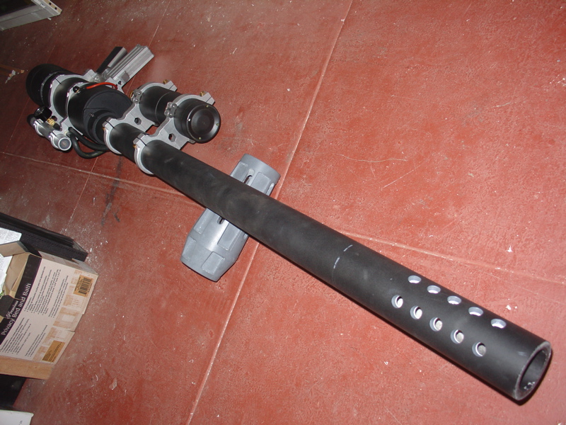

After our weekend of testing we decided to go ahead brake our muzzle to see if the success we we're having with the UHMW rounds through the 520 would follow suit with the BL-417. It did. I am still surprised the difference. In disbelief, I did one last test fire before chucking it in the indexer. Sure enough, the 1st 20 feet curves 3' left, then 10 feet later 6' down... chuck, index and drill 20 - 1/2" muzzle vents at the 60º, 120º, 240º and 300º angles and shoots exactly as the braked 520. UHMW rounds leaves smoothly and from shooter POV has small wag and corkscrew all within a 12" circle.
looking forward to this weekend. cardboard and golf ball net and box of UHMW rounds to see what kind of groups we can get.

Wow, this is some pretty damn cool stuff!
I'm diggin the Mk19 style flash hider. I really hate not having at least a mill; the CNC/CAD stuff you use is super far out of my price range, though the results are truly professional grade. It's outstanding work, really.
