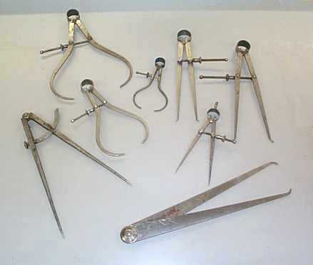

A pair of Inside and Outside calipers (non measuring) should be part of any machinists toolbox. It is a quick way to check if the part is close to the right size and can be used where a digital won't fit while making passes to check progress.john bunsenburner wrote:Well That is another thign I should ask:
I have calipers but they are manuel ones and accurate to the nearest mm, do you think I should get my self electronic ones? Also I think tigth O-rings would be better than floating ones in this gun, is there a difference in machining besides the obvious?
Set them to the target diameter and use it while advancing cuts to check depth of each new pass. They can be used to quickly turn down a piece to get it near the finish pass without having to move the tailstock and carriage out of the way to use a traditional digital or analog measuring caliper. You can quickly tell when the diameter is almost the right size before making the finish pass.
Using the inside and outside ones together is an easy way to make a piston to fit a cylinder. Use the inside caliper to measure the cylinder. (no numbers, just set it to touch both sides on the inside) Once the inside caliper is set to this size, use the outside calipers to measure the inside caliper again just touching. Using the outside caliper, you can quickly turn down your stock to close to the proper size where the caliper just fits over the OD. When done the piston will be very close to a tight fit in the cylinder. Take a finish pass of a couple thousandths and it's done. No math and the piston is custom cut to fit the cylinder.
- Calipers and Dividers
- calipers_dividers.jpg (10.57 KiB) Viewed 4533 times

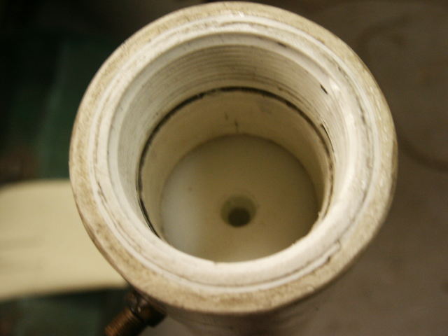

The problem with most measuring calipers are they don't measure diameter well from the side. For example my 4 inch digital caliper in front of me now. It opens fine to 4 inches. If I have a 3 inch diameter part in the lathe and am using the tailstock, there is no way to measure the piece simply because the jaws are only about 1 inch long. Try it. Block the ends of a 4 inch pipe and measure the diameter with the 6 inch dial caliper in the middle.jmccalip wrote:For a project like a piston valve, having super accurate calipers doesn't matter. You're simply comparing one measurement to another, as long as it gives you the same reading every time, that's all you need.
But Mitutoyo is a very good brand. That's all my boss uses, and he's had them for 5+ years, and they are still working perfectly. Just make sure you go with the dial kind. The problem with digital, is you never know if it's at "0". Sometimes they reset themselves, and you can mess up a whole batch of parts because you accidentally tapped the button and now your parts are off dimension. With a dial caliper, you can recheck it's accuracy by simply closing the caliper and see what it reads.
BTW, I believe the accuracy is as follows:
6" dial caliper = .001
8" dial caliper = .002
12" dial caliper = .002
The only way to measure the 3 and 4 inch parts is across the end.
When making a 2 step piston, it is possible there is no way to reach the step from the middle or the end with a digital or dial caliper.
The machinists calipers will reach where the dial and digital won't. With the screw adjustment, they rarely get bumped when set down and picked back up.
The tips of my caliper are only 1.23 inches long. It won't measure a round part larger than 2.46 inches in the middle simply because it can't reach in that far.
This is typical of a digital caliper.
It simply won't reach across a large part from the side.
Edit, quick test.. Since you indicated you wish to make balls. Measure a 4 inch diameter ball with the 6 inch calipers. You will soon discover the advantage of having the other calipers.
Get the digital. You will love it. Get the other ones too to transfer sizes to what you are working on. I'm pretty sure your boss has both.
Note the reach of the inside calipers in my earlier post. They will reach into the cylinder of my Mouse Musket where the digital one won't. The digital caliper can't measure the size the piston needs to be.
