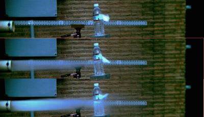

If my photography is any indication, I have gotten well over supersonic air blasts from the 2 inch cannon. At 1,000 frames a sec, the front can be seen at over Mach 1.5. The flow looks to be traveling at over 4.5 feet in 2 ms.
3 frames of video 1 ms apart.  Shot at 1,000 frames per second.  How fast is the flow?  The marked pieces of tape on the ruler are 1 foot apart.

Ragnarok wrote:The other thing that gets on my nerves a little is that people seem to think that GGDT is a substitute for genuine real world results.
