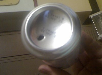

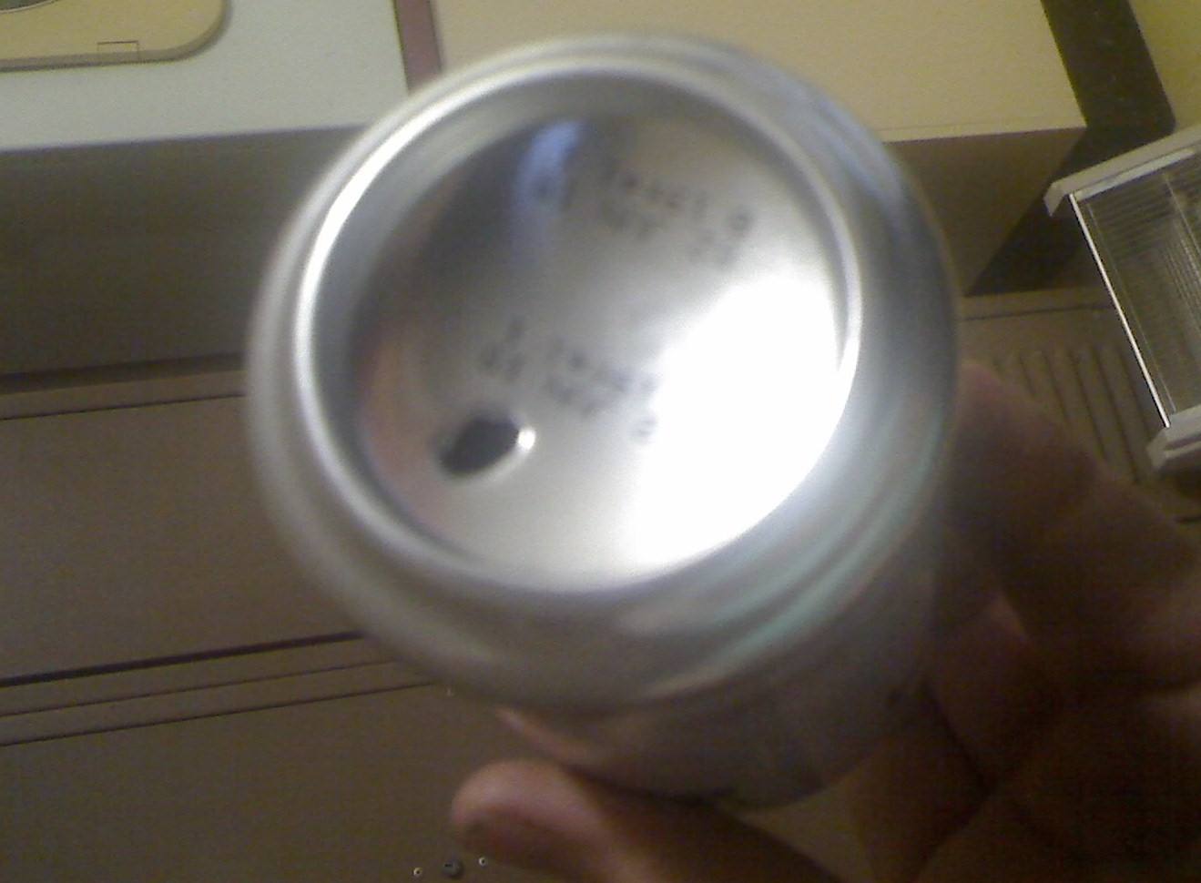

I was wondering if anyone would be able to tell me how many fps my projectiles are travelling?,i dont know how to use ggdt with this setup.
i read somewhere that if u can shoot through both sides of an aluminum can (top to bottom) its in the 500fps range is this correct?

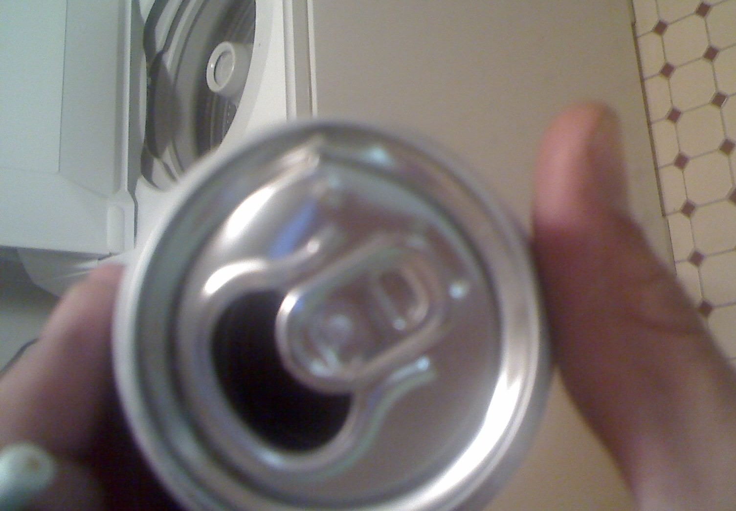

here are some pics,the first being the underside of the can and the second it where it hit the seam/fold in the top of the can i presume it would of went through if it didnt hit the seam being twice at thick at the base..

It depends on BB weight. My airsoft AEG shoots a .25g BB through the bottom of a can and dents the upper side, and it's not going in the 500 fps range, more like 380-400 fps.
At 800 fps, a .12g BB will go through the bottom, and shatter instantly, leaving small dents on the upper side.
On a side note, my barrel sealer shoots through bottom+upper+bottom sides when two cans are lined up. (at 250 psi with .24g bio BB)

FORE..the poor man's chronograph uses .20g airsoft bb's.
Seen as your gun has a bore smaller than 6mm, and we live in Australia I'm going to assume you aren't using airsoft bb's, which changes the "readings" completely.
I'll get a shot at the bottom of a can with mine..

I would be more then happy to chrony your gun,if your ever in the north of NSW I have an F1 it gives reliable readings 99% of the time.
And penetration of an object at target has largely to do with sectional density,not velocity.But your can't have one without the other
