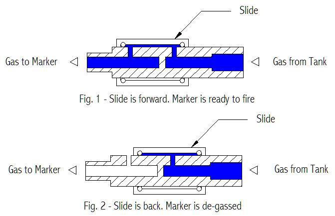

What you are looking for, my friend, is a slide-check valve.
Position one: Fill gun
Position two: Close up feed line and vent other side to atmosphere.
A slide check does that. They are relatively simple to build yourself (if you've got a lathe, its a piece of cake)
EDIT:
Added pic of slide check.
Pic of a slide check valve. This valve does what you are looking for.<br />They are used on paintball markers instead of ball valves, as they vent the marker to atmosphere (security), next to shutting it off from the feed line.
