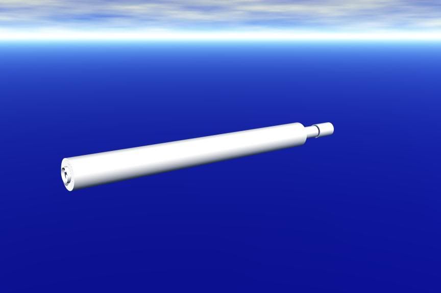

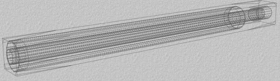

this is what im thinking, so it can be removed as needed its about 35" in length
maybe with insulation inside or something else to absorb the sound
I would still consider cutting down a little on chamber volume as well as making a suppressor/
Northir wrote:maybe with insulation inside or something else to absorb the sound
(Ignore the dimensions, this was from another design)
The inner tube should be heavily ported, and you could have wooden disks (or be original, cut down soda bottles/ drilled out soup tins, there are countless improvised possibilities, I even used lego blocks :D) spaced out as baffles to make it multi-chambered and more effective.
