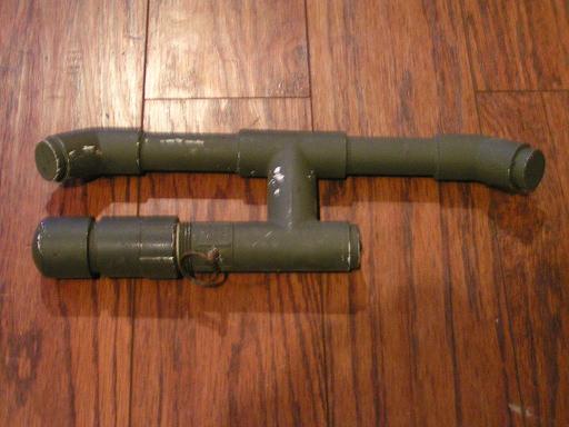

Alright guys, here is the first prototype:
Animation of the design:
http://img707.imageshack.us/i/tripmineanimation.swf/
picture of design:
The trip wire is pulled, the support piece gets pulled with it and the spring tension is released causing the grey piece to slam down on the co2 cartridge.. there is a sharp point at the bottom that the co2 rests on.. once the gray peice (bolt in my case) is slammed into the co2, it lets out the co2.. it goes up and out the T.. the T can be hooked up to anything..

SEAKING9006
Posts: 734
Location: Texas
Well done mate. Now try and find a good way to use it and lets see it in action.

David: Good job, but there is an immediate safety concern I see. You need a pin block of some sort. If you pull that spring back and it slips, you probably won't like the results. I used a simple pullpin on my bounding mine. I remove it once the trigger is set.
And, I don't know if you have seen it or not, but DVLCHLD has duplicated the pressure activated master mine. His stands just a little over 4" tall and has a 4.5" pressure plate. I've built several and they are, by far, the best pressure activated mines I've ever used. Total cost is around $5 per unit to build.
I've also posted PDF documents of the tripwire Master Mine as well. You should check those out. They are what inspired my bounding mine.
Oh, and if you need any assistance, please feel free to ask. If I can't help directly, I'm almost certain I can get you pointed in the right direction.

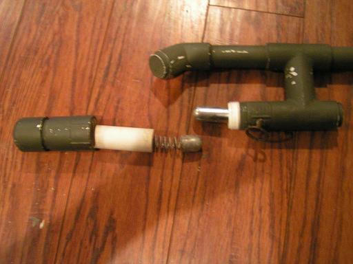

Here is a trip wire mine I made up acouple of years ago. Mostly 3/4 pipe an fittings. Breech opening is made of 1 inch female and cap with a 3/4 section inside for spring gidance. An a 1 inch male to 3/4 adapter, Springs an all material i found at home depot. Plunger head is a 12 gram co2 end i cut off a spent canister.

Update
Well it is winter here in wisconsin again and with every winter, I get bored inside and I want to start building things.
I decided to touch back with this project to see if I could get the reliability of the design increased, and make the design shorter and smaller. Well after playing around the other night, I was able to make the design smaller. I noticed something about the pins I was using. The nails were tough enough for a while, but they would slowly pop out over time and dull. I tried a screw, but it was a really cheap aluminum screw that just dulled right away. The spring pressure on this mine was too strong, so I decided I needed a weaker spring and a sharper more stable pin.
So I went with a stainless steel self drilling screw. I went with the smallest in diameter I could find. The next thing I did was I purchased an assortment of springs from menards to find which one would be the best. I finally found one that seemed to be strong enough and worked well with the screw I chose. The screw went kind of wide however right away so it didnt make a deep enough hole in the co2 cartridge. So I decided to file away one side of the self drilling bit and that increased reliability a lot.
I will continue to test until I find the best most reliable pin/spring setup.
The great thing about this design, is that you could replace the "support beam" or sear with a wider peice of metal. This would make it so that you could pull the safety pin out, and toss the "mine" into a room, once it lands, it will pop the sear out and cause the mine to go off, esentially turning it into a safe airsoft grenade. (in theory)
