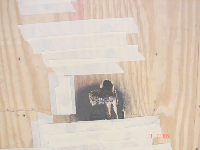

Test Shots:
100 ft @1000psi nitrogen
3 round group
3 round group from 100'
PDS-32A 04-03-2010 003.jpg (32.66 KiB) Viewed 4757 times

HOT DAMN! That was a 3 round group at 33 yards? Thats quite accurate, and my god, quite a bit powerful too. Looks like its time to invest in some really serious sand bags.
Just realised I happen to have a ball bearing of the same size you are shooting, these things are heavy! I was planning on shooting one from my hybrid but haven't got around to finding a barrel yet. The damage doesn't surprise me at all!

I assure you....it won't even slow down for a fridge!
