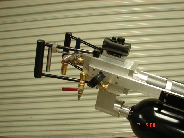

Well....I did it as I'm sure many others have.boyntonstu wrote:Great!velocity3x wrote:Excellent idea but, far from unique.boyntonstu wrote: The Trom-Boyn is pressurized through the pilot vent and hence the piston will uncork an re-seat itself at the breech for the next shot.

[/quote]Well....I did it as I'm sure many others have.[/quote]
How does your piston lock open?
Has anyone built a locking piston in a copper cannon without using a lathe or milling machine?
(I did it today)
(I did it today)
