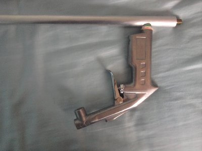

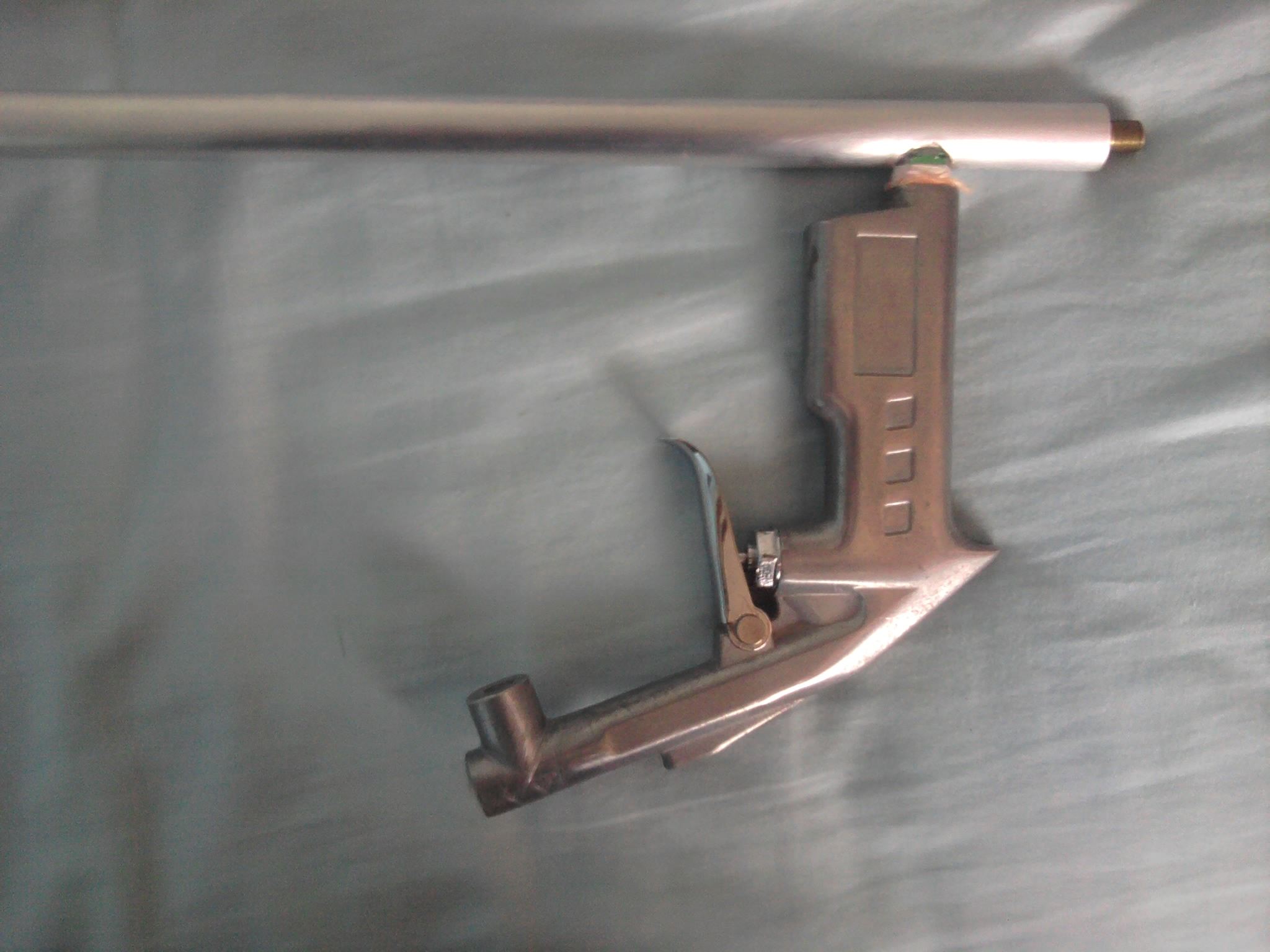

Even when installed properly, many blowguns leak at high pressure. When I took a bbmg of mine to those pressures I had to use three different blowguns before I found one that could take the force and not leak. You might think about replacing the blowgun with a pushbutton valve, they sell them for pretty cheap at mcmaster and they will still give you that trigger feel. Plus, if you decide to up the pressure from 400 they will take it without a problem.
ilovefire
Posts: 511
i got really pissed at it so i took of the blow gun and replaced it with the one in the picture and it can take 400psi, power has gone up significantly i think i was hopping for a bit more but it i am quite satisfied with it anyway, altho it dose look kinda stupid and dont believe i will make a stock for it if i keep it on there, i will look around for something a bit better but at the moment i dont have much money so cant really do much in the way of buying stuff, will try get some vids soon, might have to make that silencer that JSR was suggesting because this thing is quite loud, not deafeningly, but a bit much for suburban australia. all in all im not so dissipated with it as i was before, has anyone successfully modified a blow gun to not leak?

A 1/4 male to female right angle fitting would allow you to use a 1/4 ball valve as was suggested earlier, a nicer trigger could be fitted too.
