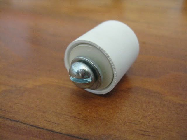

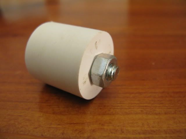

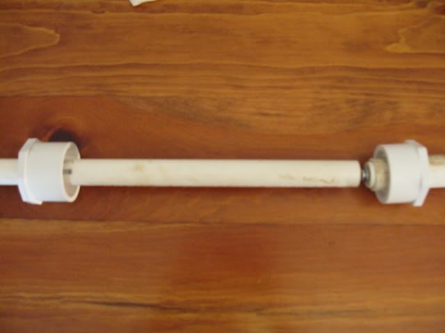

I just turned the piston out of the 1/2" PVC endcap. I used a piece of sheet PVC to make the other face. the only thing left to do on it is add the sealing face. I really took my time on the lathe so the piston is really smooth and fits perfectly in the 1" pipe with a very small amount of friction and a very good seal. See the pictures below of the piston and the bones of the cannon.
My concern now is that the pison is the exact diameter as the OD of the 3/4" barrel.
Will the air in the chamber still be able to open the piston since there is no piston face area around the barrel that is exposed?
Piston Front
Piston Back
Overall layout dryfitted together. just need the pilot valve and 2" PVC

- Technician1002
- Posts: 5189
If you slightly taper the end of the barrel (gently sand the end smooth with sandpaper so the end is slightly rounded) This will make the diameter of the valve seat smaller than the OD of the piston by enough to make it work well.

No, because the pressure has nothing to push on. If you do what Tech said, it might. Looks very nice so far though. Remember, those bushings won't go directly in the pipe... it needs couplingsWill the air in the chamber still be able to open the piston since there is no piston face area around the barrel that is exposed?
I sure hope this works or I'll have done all of this for nothing! I'll work on tapering the end of the barrel but I'm nervous about this working. Is there any way to calculate what area of the piston needs to be showing to get this to fire?Gun Freak wrote:No, because the pressure has nothing to push on. If you do what Tech said, it might. Looks very nice so far though. Remember, those bushings won't go directly in the pipe... it needs couplingsWill the air in the chamber still be able to open the piston since there is no piston face area around the barrel that is exposed?

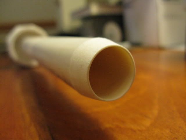

Update: tapered the barrel. The OD of the new tapered face is .89" and the piston face is 1.02" measured with calipers accurate to the thousandth. I hope this leaves enough barrel material for the piston to seal against. Here are some pictures of my work and how the piston/barrel line up.

That looks nice, hopefully the seat will hold up. What pressures are you planning to use?
No more than 80 max. Probably average around 60-65. I'll try to pilot it with a modded ball valve but may step up to a 1/4" ball valve if I need to. I'm hoping that this will give it enough area so the piston will open and the seat will hold upGun Freak wrote:That looks nice, hopefully the seat will hold up. What pressures are you planning to use?
