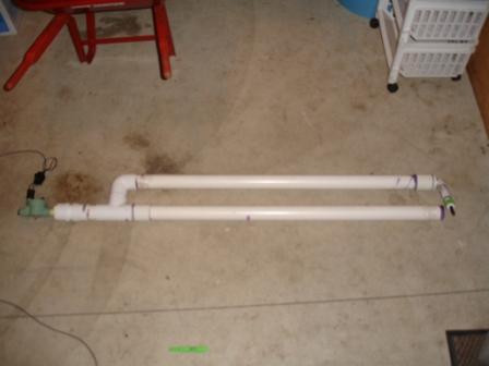

Well I made it yesterday after a surprisingly short trip to Home Depot. It went together pretty smoothly, but today when I began to test it, some problems came up. It appears the the 1-1/4" end caps I got for the ends of the piston are slightly convex on the inside, so the neoprene check valve in Hubb's plans leaks no matter what. Not too big of an issue, just some lost efficiency. It can be fixed later.
However, there is a bigger problem. I can't get the piston to make a good seal for the life of me. It leaks slightly until about 20-30 psi, and then it just lets go, dumping the chamber in a few seconds. I think that the neoprene seal is deforming enough at rising pressures that one of its edges just slips beyond the inside of the 1.5" PVC sealing face. I think this is due to a combination of factors.

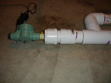

Until then, some pictures of my progress. The second Schrader valve sticking off the chamber is there just because I didn't have a threaded 3/4" plug handy.
The parts I started out with
3 and a half hours later, the final product
Close up of the fill valve and pilot area
