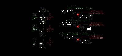

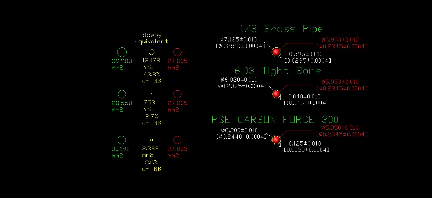

Warhead, here is is a comparison of blowby percentage based on the BB diameter. Basically it shows loss of power between barrel types.jackssmirkingrevenge wrote:Yes, but a bit more than that - in that a tiny difference in barrel diameter (just 0.5mm or 0.01968 inches in the example above) can make a disproportionate and extremely signifcant difference in performance, so it's worth the effort to find the closest possible fit between projectile and barrel.warhead052 wrote:Is it pretty much saying that the tighter the barrel, the better?
Your 1/8 inch pipe requires about 40% more power than a tightbore barrel.
Your pipe barrel would require 140 psi verses 100 psi for a tight bore for equivalent power.
This should explain why you need a tight bore barrel.
