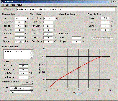

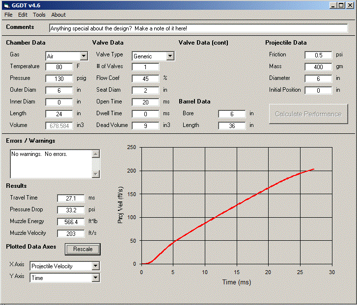

Here's a ggdt example.

Hmm, You mention a Fire Extinguisher and then list a large chamber in GGDT. I was going to mention a BBQ grill bottle instead. For a 6 inch barrel, I would recommend at least a 5 gallon tank and a valve larger than 2 inch.
