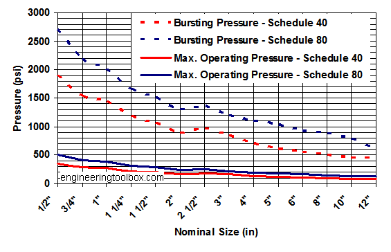

The published tensile strength for pvc varies widely...is it safe to assume that you obtained the information from the manufacturer?
Would you post the manufacturer and the tensile strength? It's good information to have.

The manufacturer is Charlotte Pipe, but i could not find the manufacturer specs. Theyre out there somewhere, i just got tired of looking so i found this resource from engineering toolbox to have a nice estimate. I tested the pull out of the screws with weights, then calculated the psi required to create the same effect using the surface area of the screw holes. I wasnt concerned about their shear strength since it had PVC cement to help it, but i guess it couldnt hurt to go back and do the math.

- pvc-pipes-pressure.png (15.52 KiB) Viewed 3611 times

Yes.So would floating o-rings be the best solution to the problem?
Charlotte 1.5" is rated to 330 psi.
Scrap your chamber, please.
