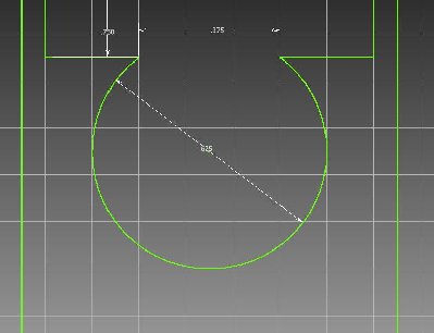

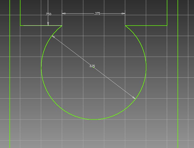

all right, more questions. the drawing seems under dimensioned. are these assumptions accurate?

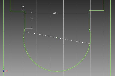

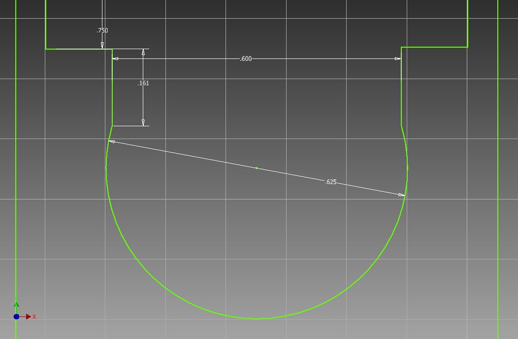

Alright so everyone can call me a moron forever, because I've clearly forgotten everything I learned about dimensioning.
SO, this one should actually be correct!! Take a look, made a couple changes, so let me know!

All right, knock on wood, those look good
. We'll see if I change my mind again...
And don't beat yourself up over this. I was about to drill, then I realized the ambiguity
. THAT would have been bad. Just like you usually don't get parts made by others from drawings, I usually don't' make parts from other people's drawings.
One thing to keep in mind for everyone who might be reading this: It makes things much easier if you call out all dimensions for a side from the top left corner as it would sit in the vise, and call out to the center of features like slots or holes. Depths are best called from the top of the part.
One thing engineers lack (or so I've heard) is an appreciation for how things are actually manufactured. This is not a rant, simply advice on how to become better engineers.

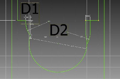

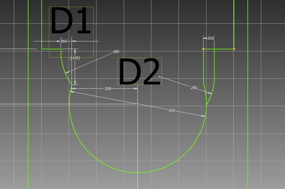

Some options (These are wanna be section views):

Thanks for the clarifications ramses, lets go with a normal end mill square.
