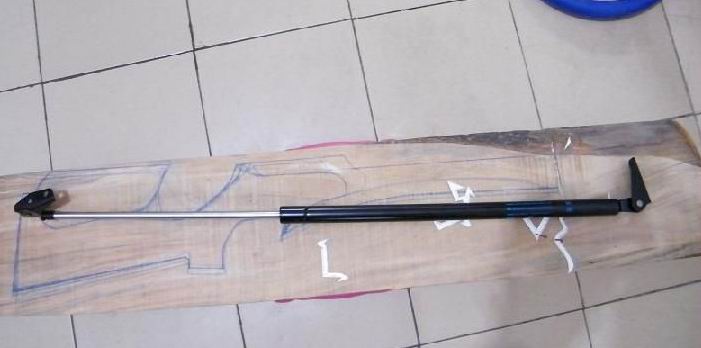

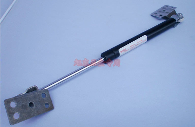

In China,Buy a refrigerator compressor to $ 70,
I chose a relatively low cost "gas spring" to transform
Cost is only $ 3

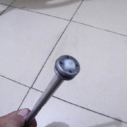

Brilliant
idea! Ready made piston head, pump body, and that can take a lot of pressure!
What pressure can you reach with this setup?

If the transformation is well, you can hit 4Mpa
Could you explain how to 'transform' it?
(how to modify it into a pump)
POLAND_SPUD wrote:Could you explain how to 'transform' it?
Seems fairly simple - drill a hole in one end and add a check valve.

Wow thats a great idea, i am right in thinking that those are the things on the boots of cars right?
killerbanjo wrote:I am right in thinking that those are the things on the boots of cars right?
Yup... you want to find one with a relatively small inner diameter (sub 0.75") and long stroke to be a useful pump. Or you can get that fridgy working ;)
