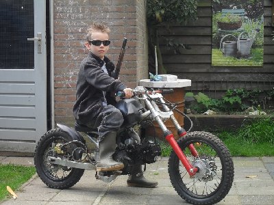

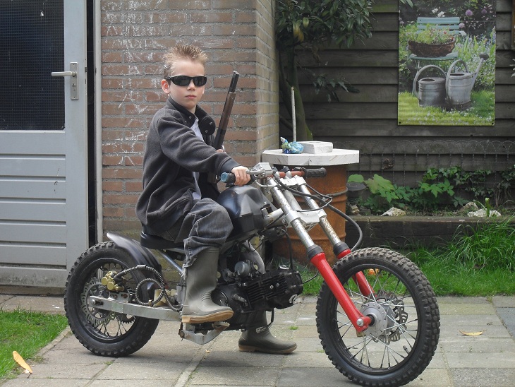

By the way..I decided to chop the pitbike that has been gathering dust..
I'll be welding up the hardtail and stretching the enginemounts tomorrow.
Lowering it this much makes the engine tip up...
Finally my son can fit on the bike and handle it.
He insisted on being photographed this way..
I don't know where he gets it,,,honestly..

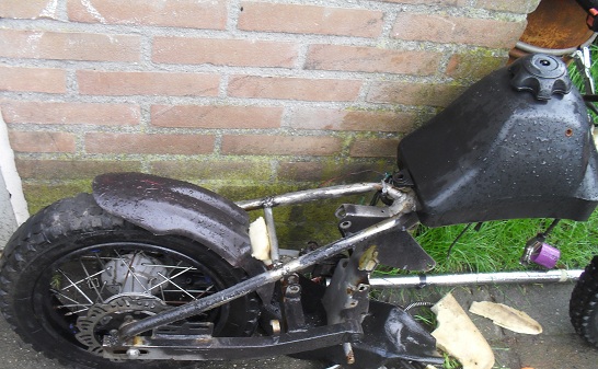

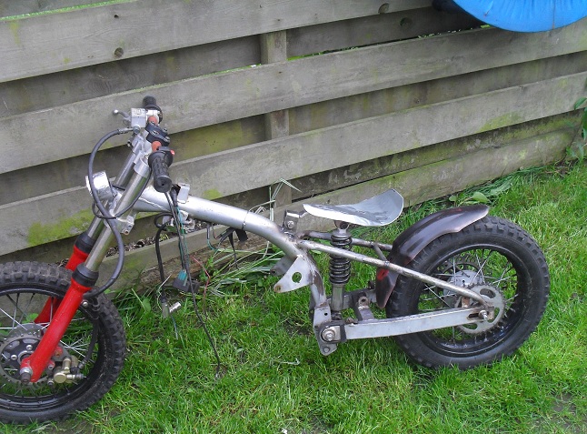

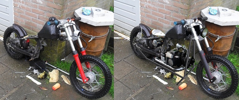

I hope you don;t mind me posting my progress in your topic, but since we're both kinda doing the same thing I figured it would be best.
I see no reason to steer attention away from your build either.
Let me know if it bothers you and I'll start my own thread..
I haven't done the enginemounts yet by so far I have completely welded and braced the hardtail.
I have also cut off all unwanted brackets and stuff and I welded on the hinge for the soloseat.
It will be floating on the original monoshock that I will mount discretely tucked away near the bottom of the backbone.
I already turned down the factory preload on it to minimal and I plan to install it very close to the seat hinge for a very comfortable ride.
For now I can share yesterday's pictures right after tacking it together and a mock up-picture to see what it should look like.
Welds are all done and rock solid now.
