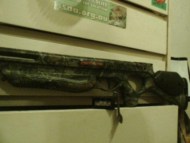

Hey wyz, can you make that set up a bit smaller, so i can fit it in this stock, :wink: lol.
Reason: Fixed video.
wyz2285
Austria
Posts: 2390
Location: Porto, Portugal
Check out the "how to make a semi-automatic airgun for beginners" thread (I'm on my phone so I can't link it, it's in the how to data base as well). But basically you just need to use a smaller 3-way and cylinder (probably order a custom one).
