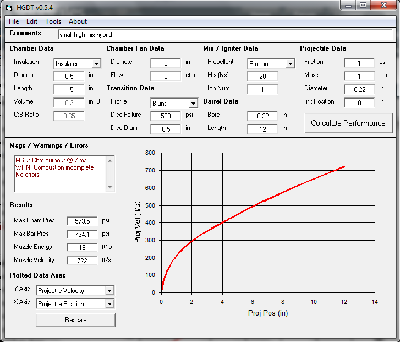

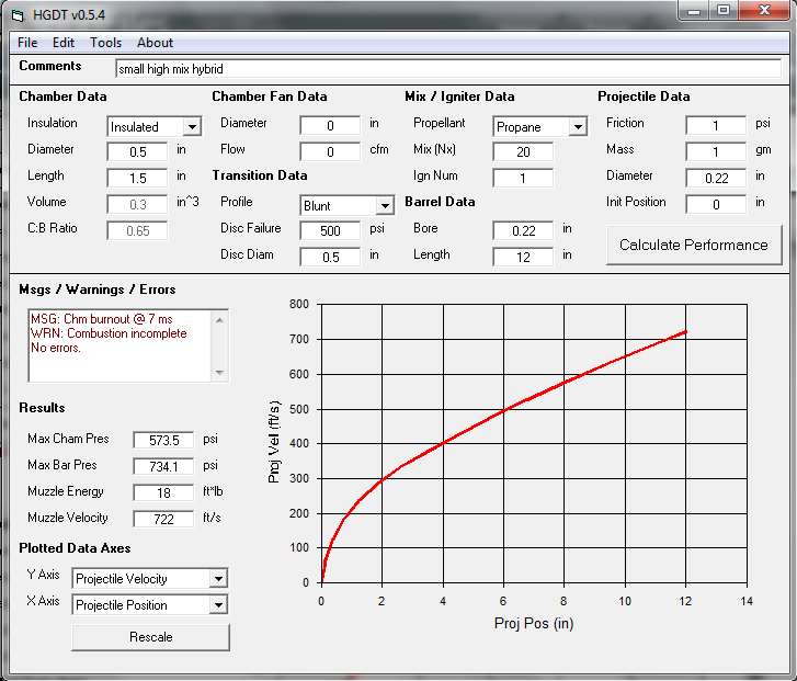

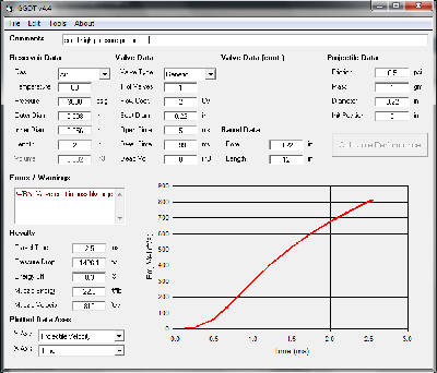

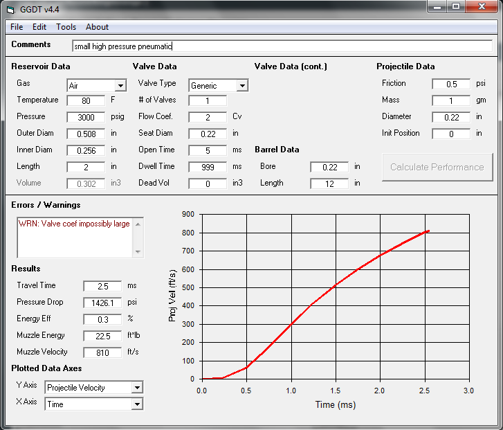

Here's a GGDT/HGDT model comparison between a 3000 psi pneumatic and 20x hybrid with similar barrel and chamber sizes firing similar projectiles.
Note that the hybrid gets similar performace even though maximum chamber pressure is around 20% of the pneumatic.

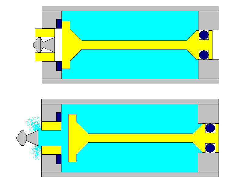

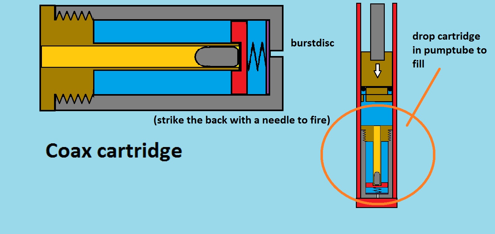

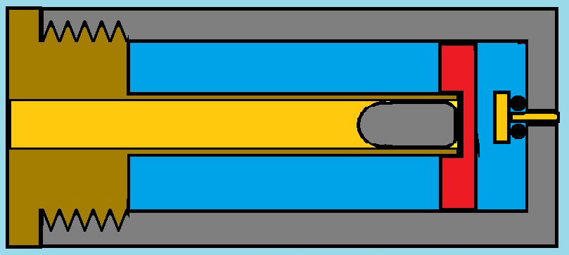

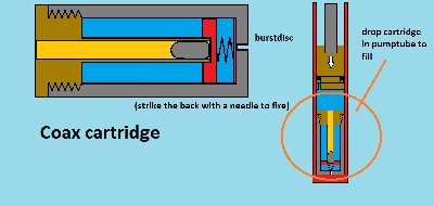

Did anybody try this yet:
Why not this, that way you don't have to dismantle the cartridge and replace the burst disk every time.

With one spring keeping the piston and poppet in place...I knew you'd say that. :D
The way you portrayed it will have the poppetthingy sqeeze off the O-ring..
I realised I should have drawn the hammervalve type in the first place after I uploaded it.
The reason I didn't change it is because with a sharp enough spike, you'd need less force to hammer it at 80 bar+
The "gun"that would fire the cartridge would also be evidently different from a firearm, wich would be smart to avoid a misunderstanding about it's legality.
It should also have a ridge to extract the cartridge from ., perhaps.a..breakaction doublebarrel?. 8)
..and the cartridge is then put into the bottom of the pump so the plunger can stay in..

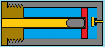

Here's a thought which came to me as I was trying to sleep, a slightly unbalanced spool valve cartridge. The rear o-ring is slightly less diameter than the front seat so the pressure keeps it shut, but it can be opened with a couple of kg of force. The "hammer" would push the whole cartridge forward, a bit likethis. The spool face would be pressed against the breech face, voila.
A higher flow version of the Brocock...

I'm still convinced a coax piston type cartridge is best.
I might try the burst disk to pilot.
It will be less complex and very compact.
Only time will tell if it's too cumbersome to open the cartridge and drop in a precut aluminium disc.
( holepunch and redbullcan)
Piercing a burstdisc at high pressure isn't very hard

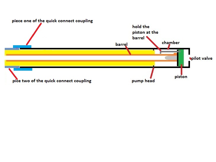

Jeans idea had crossed my mind ( probably seen it before) but the barrel can only be fixed in position by adding an flow-obstruction in the reservoir.
Not the usual coax spacer..it needs to be chunky enough to keep the barrel in safely at extreme pressures.
sry for the hijacking
cant see the issue with the chamber
locking the barrel can be by a quick connect at the other (non chamber) end of the pump rod/tube like this
the chamber itself will be no longer than 1-2 cm no support for the barrel needed?!

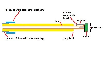

jean wrote:cant see the issue with the chamber
Jean, are you suggesting that the barrel itself also move with the "pump", ie the yellow part of your diagram and the barrel are one piece?

yes see the problem may
you can hgdt ggdt it for me i am in the hospital at th
e moment.
barrel 1m / 8mm
chamber 80 bar / 1cm2
why not preload the chamber?
on the other side 12ftp of energie are ok for me
maybe my next project
and yes barrel an pump rod one piece
jean wrote:why not preload the chamber?
It will work, but of course takes away the whole convenience of having a launcher with an integral pump...
