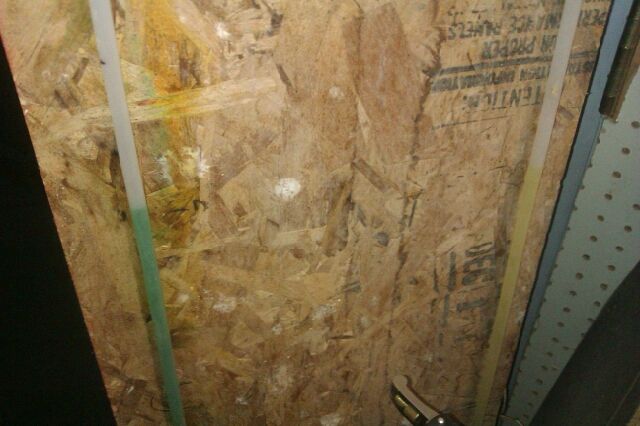

25.6 inch height difference = .925 psi propane
15 psi air
Hail to the potato launcher god(s)! It works every time!

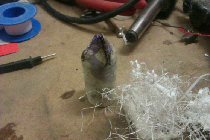

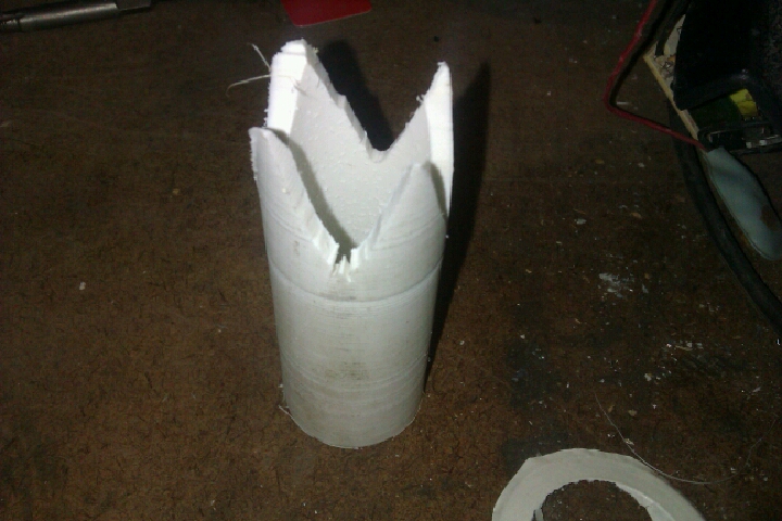

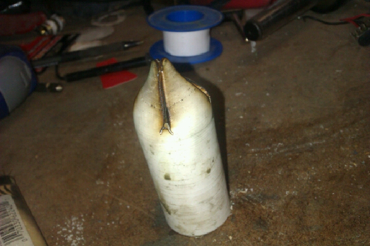

Also made a projectile out of 3/4" pipe. Gnarley looking, but cheap.
15 psi air
I hadm issed this working, good job
