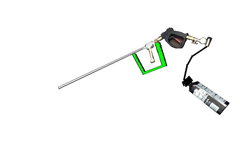

If you directly connected the output of the popoff to the barrel (epoxy would be your friend in doing this) , it would 'vent' all of the gas from the pop-off to the barrel, so essentially all the gas is used, it's a long shot, but it might work better than trying to reduce the amount of gas 'wasted' from the pop off.
- The green bit
- Perhaps.JPG (20.08 KiB) Viewed 2971 times

Good point cammy, but the gun can still be made more powerful by tweaking the flow. In the end, with a a properly tuned system, redirecting the pilot exhaust to the barrel should barely have any effect on the performance of the gun because optimally the QEV should be very powerful on its own.
