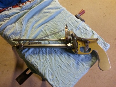

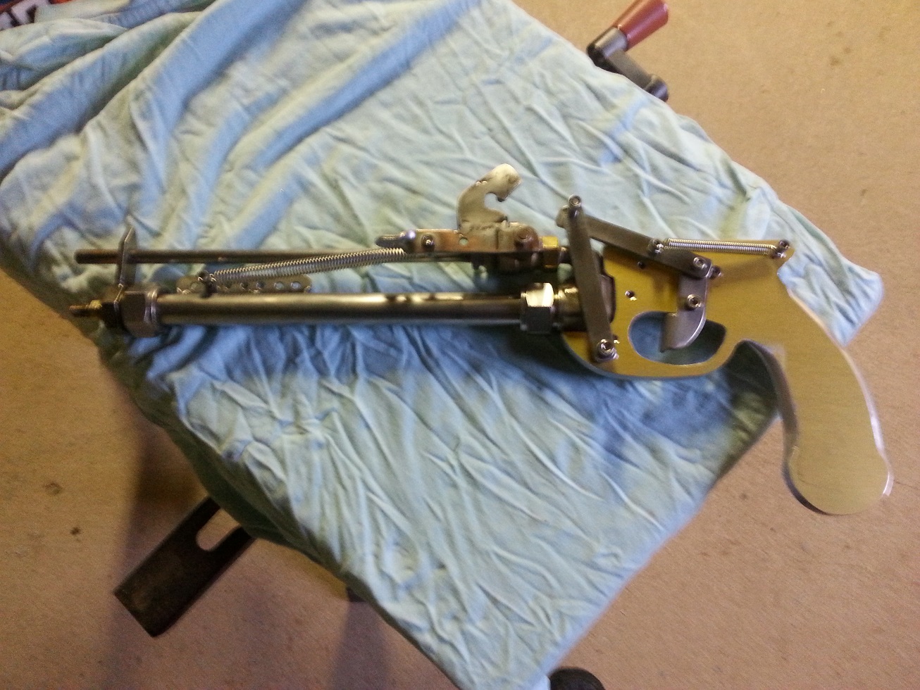

The Rube Goldberg ready for first test fire, the ball valve does leak a bit as predicted so the shot has to fired quickly after the chamber is charged, might try and shim the seal to try and stop the leak. Fired 6mm airsoft in the 1/4" barrel and it was reasonably accurate at short distance. Mechanism works great and trigger pull is quite light.

Thats very good ! I'm waiting for the video of the shots :bounce: :bounce:
How many shots pressure do you want to use?

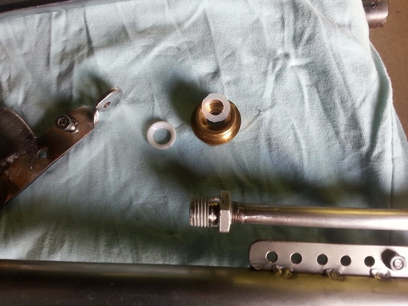

Made a shim to tighten the ball valve seals, used a piece of plastic milk bottle, it's good stuff for shims and low friction washers. :idea:
Seems to have stopped most of the leak, now I can charge it and fire still with good pressure left, I took it up to 150psi.

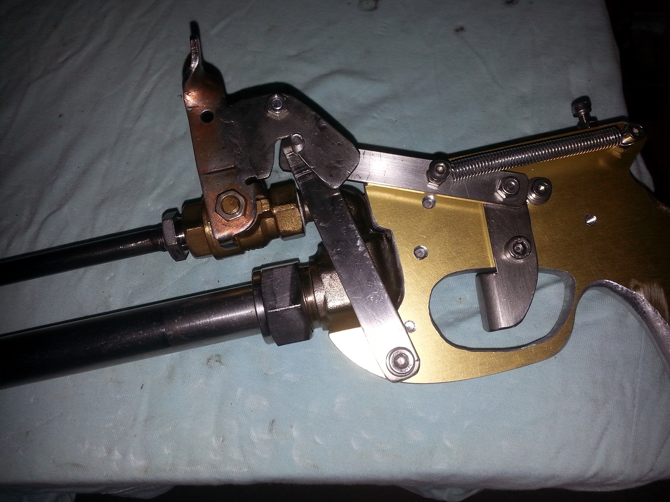

Reshaped the mechanism a bit, it cocks and fires now as I wanted it.
