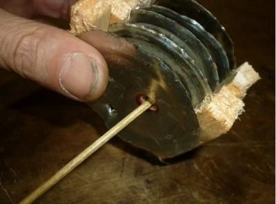

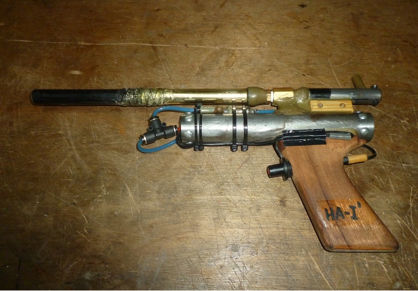

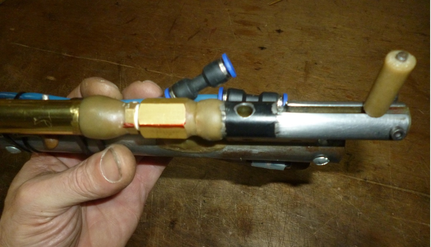

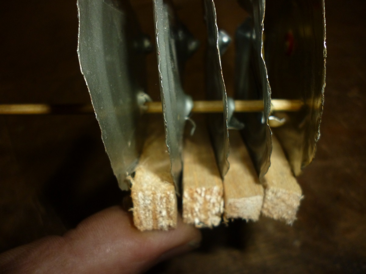

I made a modification to this short weapon. I have tried to include an adjustable holding o`ring and I have added a manual ammunition loading system. Also, I added 10 cm of firing cannon.
The result is that power has increased a lot. I'm working at 5.5X and everything else is the same as before, I mean the spring, the volume of the combustion chamber and the amount of butane gas.
Before, he was drilling two soup can discs and now drills 4 and almost a fifth. The shots were made from distances of 3 meters, in both cases. and with the same ammunition of 1/4 "steel.
Of the modifications, the most important thing is the inclusion of retention, which is responsible for the increase in power. I will include this technique in my other weapons that fire lead or steel BBs.
It is a test weapon, to try different things, that is why I keep it active, and for this reason it is all untidy. The aesthetic objective is not
I leave some photos of the modifications and the effect.

That's an impressive increase in performance!
In English we say "pretty is as pretty does", it's the opposite of "no basta con serlo, hay que parecerlo"
I really wish you had received the chrono to be able to quantify your progress with numbers instead of Box O'Truth style experiments, oh well.
It's got a certain post-apocalyptic aesthetic and is beautiful in her own wayhectmarr wrote:The aesthetic objective is not

Yes, the aesthetic is secondary but personally, I like it. It can be said that it is "horribly cute"
