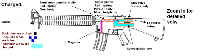

This is a diagram I drew in paint its not perfect and has alot of problems but it shows the main concepts
The light green is the room I got to play with the exhaust, the rest is pretty much self explanatory except maybe for the bolt system.

Okay dude, so you want it semi-auto. That's where it becomes expensive. I'm sort of in the same boat as you although I'm replicating an m107 .50 cal rifle. It's very similar to clides semi auto (search) but with a few mods to the piston, slide valve and loading mech and a built in hpa source. I fiddled with your m16 just incorporating clide's semi-auto design into it. Its fairly simple (you probably can't see the detail too well because it was saved as a jpeg...) although the parts will have to be machined out of metal. And if you were really keen on building it, it shouldn't seem too much work. (Check twice, machine once...) I'm using a 68ci 4500psi hpa tank with a 40cm remote stainless mesh hose, a few fittings with a 0-800psi inline stabilizer as the onboard hpa setup, and if you play around with it for a while you'll figure out a way to fit it in your stock. (Maybe not the 68ci tank, there are smaller ones though) You'll also need a safety valve and some means of connecting the slide valve to a trigger. I was pondering on using a bicycle brake line to solve that. Just remember semi auto's aren't a quick, easy or cheap project and hence why not many have built one. All the best
I had another look at CpTn_lAw's design and the only thing I don't like about it is the dead spac behind the magazine i know that could be fixed by having thepiston in a T but I don't think I would be able to fit it inside the gun and keep the barrel where it's supposed to be. one thing I like about it are the electronic iterupptors i'm gathering that they are some type of electronic valve or electromagnets "please explain".
The jolly rogers's Idea gave me some good Ideas but the only thing I don't like about that is the magazine system, I know I can use a different one bet anyway.
here is my latest design
this is the jpeg
this is the bmap
I'll go throught the operation quickly
1. squeeze trigger.
2. small electronic valve opens.
3.slide valve bolt is pushed forward quickly by the air from the chamber.
4.slide valve opens.
5.piston exhausts.
6.Projectile fires
7.chamber losses pressure.
8.Spring pushes slide valve closed.
9. electronic valve closes.
10. Then repeats.
I haven't quite figured out how the bolt will be operated yet but you can see the concept I plan to use in the picture"I hope".
EDIT damn photobucket only loads jpegs the bmap file was alot better.

Dude thats a good idea! Complex but it would work. I didn't look into the loading system as it would be fairly easy anyway (hence why I didn't really emphasize in my sketch) but your firing concept is quite good. Of course if it could be done just as effectively with a simple connection between the trigger and slide valve (the trigger pressure would depend on the springs holding the slide valve closed) it would make it alot easier (kiss). Plus I think he wants one that is built for high pressure (300 - 400psi, i think unless I have the wrong thread) which means he will be extremely lucky to find a suitable solenoid valve, let alone be able to afford it.. But apart from that I like your design alot.
I know that there's no way I'll find a soleniod valve good enough let alone small enough but it's an idea. Although CpTn_lAw proposed that his idea could be all electric and it involved turning off a direct Co2 source, maybe the exhaust will just have to be some sort of QE valve.
I have run out of ideas for the exhaust valve, I am only left with either a hammer valve or a slide valve. I dont think the slide valve would work to well because of high pressures and I would need very tight o-rings making it harder to open. That leaves the hammer valve I can't think of any good ideas for that except maybe having it very small so that it doesn't take much force to open but then the valve opens slower etc. hmmn I'm stuck anyone else got any ideas, I don't want to use a blowgun but thats the only thing that seems practicall at the moment, I might go and pull a blowgun apart and see how they work.

Slide valves can hold alot of pressure dude, they use them on paintball guns to disconect the line from the source without losing air. Seacrh paintball slide check valves. Thats what I'd be using.
