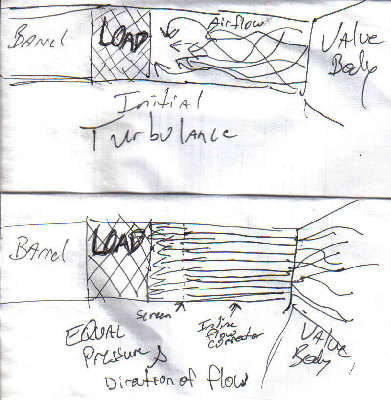

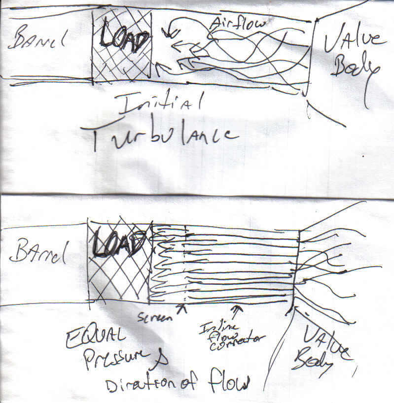

The flow corrector works on the theory of air dispersion, the same thing that keeps a hovercraft afloat a blanket of air. The pressure of the air underneath these vehicles is spread over a great surface area, giving even dispersion of lifting power. The flow corrector does the same - take a look at these diagrams I sketched up - you will see that that it is very similar in nature to the dispersion method of a hovercraft, rather this design focuses on making the flow uniform and unidirectional, thus rendering more initial power. Disney uses this same design in their water fountains that shoot perfectly tubular streams of water through the air without loosing surface tension and maintaining a floating "tube" of water. This is because the fluid (liquid or gas) is travelling uniformly as it is expelled.
BTW- That orange tip was just the thread protector that came with the tube stock. It is a 1" diam. Barrel. I have plans to rifle either a steel or ABS barrel at a local machine shop or perhaps remington arms factor, which is about 3 miles away from where I work.
Side note : My friend, a mechanical engineeer, stakes that this steel tubing would take in upwards of 800 - 1000 PSI of pressure, making it ideal for either pneumatic or combustion purposes. This Is the third cannon that I havfe built. The first two were constructred with my engineering friend, Ryan, LordDarPhyve. Both were steel, one pneumatic and one propane/flint combustiuon. The thought of rupturing plastic makes me shudder. I absolutely refuse to use a material that stresses with heat, cold, chemicals, sunlight, etc...

The flow corrector sounds plausible.
Whats it made from?
I have this sudden urge to stuff a cut down bundle of drinking straws in just after the valve in my cannon to see if it makes a noticeable difference
Whats it made from?

You guessed it - drinking straws crammed into a small 1" dia pipe with a retaining screen to keep them arranged properly. You would notice a slight twist in the arrangement if looking on from the front.
