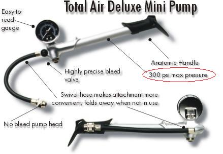

VERY nice rifle. I can't get bike pumps to go past 300 PSI without them breaking, though. :lol: Is this going to be a contest entry?

already is man. i bet i can get this pump to 350 after the footy season is over (AFL that is)
you need one of these:
Image and a girlfriend*
*because once you're done pumping to 400psi, there's no way you'll have enough energy left for any self-indulgence you might have been planning :D

meh mini pump, the fact that it says 300psi max not 300psi rated turns me off it a little im also making a 16mm bore pump from the plans that b the b
posted.

I have the exact same model and I've been taking it to 400 psi+ (well off the gauge...) for years now, the only maintenance I've ever had to do is a few cents worth of O-rings on the piston.
Re: the g/f comment, I meant you'll need one because after using the pump you won't have any strength left in your arms :P

oh nice but i have seen a better shock pump in a store close to me rated 450psi so when i get the cash i might get it, or a reg and bottle.

So chaos, for what prices have you seen decent pumps that are 300+psi rated? I came across a similiar one to what jack put up, for like $60 ($Aus of course!), with a gauge that went to 300psi, unsure if it was rated to that or not.

the one i saw was a motorbike shock pump it was about $180 AUD rated for about 450psi
